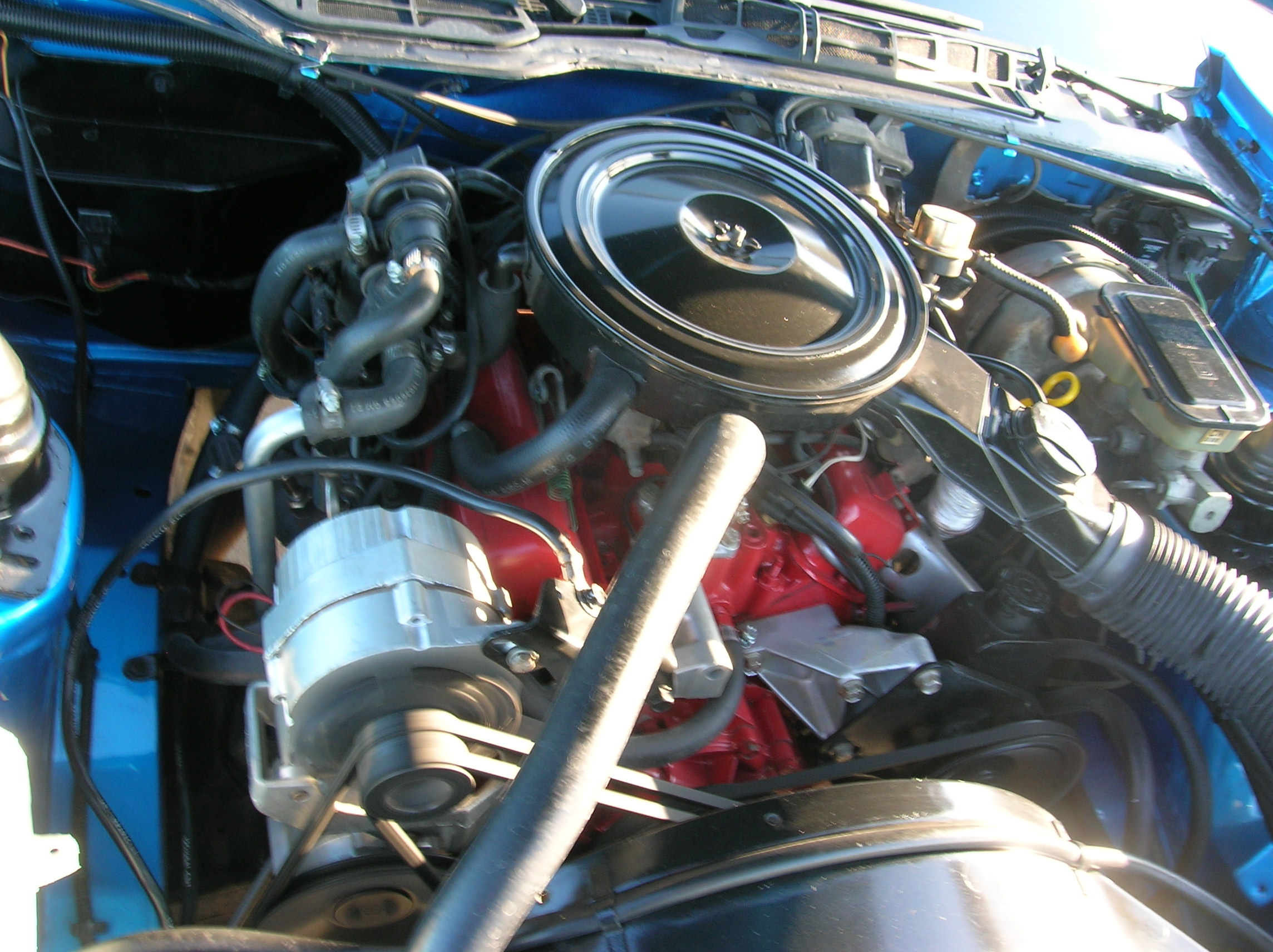

I recently swapped out my 2.8 card v6 and im ready to drop in a fresh 383 stroker carburated. Can anyone let me know what im all going to be needing for wiring? I am running a HEI Distributor with vacuum advanced and im pretty sure ill be fine with the wiring for that but i dont know what im getting into with the alternator or any sensors.
Ive searched TGO alot for stickys on this but no one really posted anything on a v6 carb to a v8 carb swap...
Thanks alot

Is my car even going to have an ECM being that its a carbed v6?
What would i have to do to get my mechanical pump working thru the intank pump then tho? That whole issue passed right by my, thanks alot for bringing it to my attention

If this is the '82, then you wouldn't have a in-tank fuel pump on it since it was carbed originally - so no need for any regulator or worrying about the in-tank pump.
