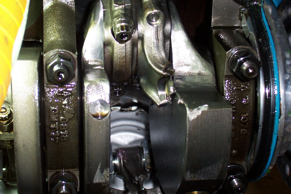

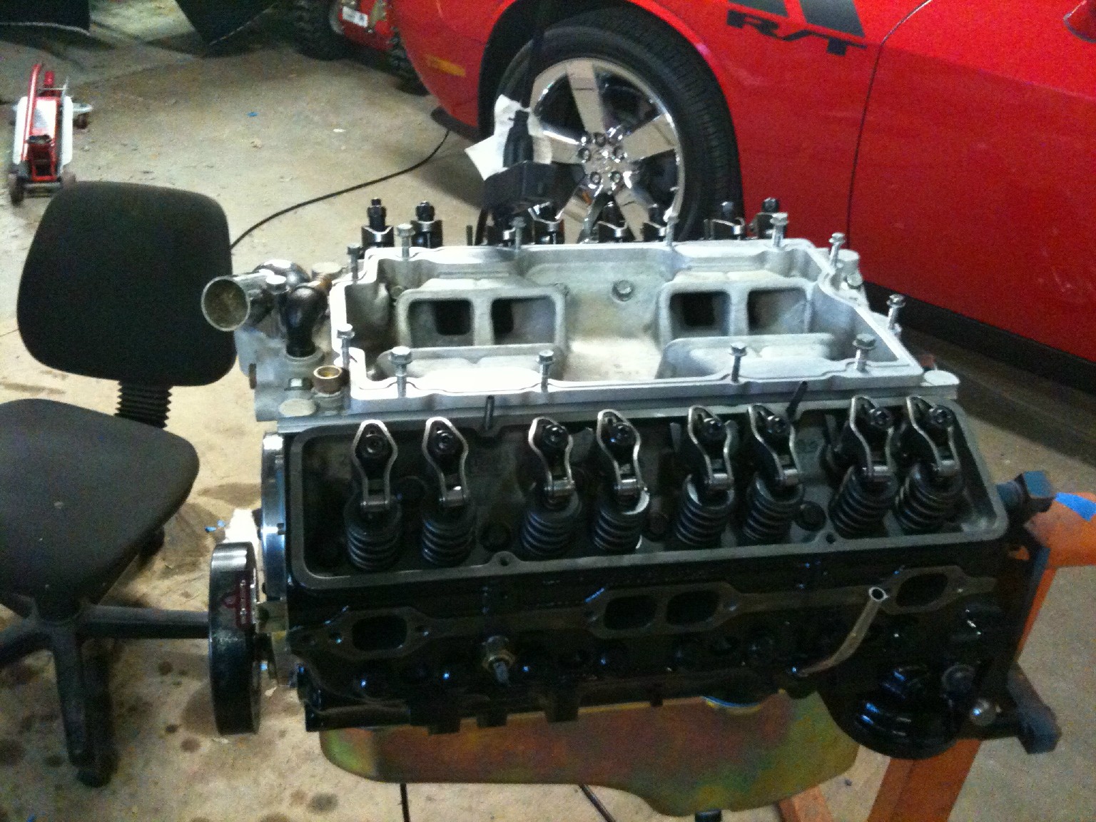

Finally get my car painted and the guy at the body shop calls me to tell me my engine started making a bad noise when they tried to start it. Car ran great when I dropped it off there. I ended up pulling the engine (carefully) and here's what I found.....
The whole bottom end has a forged crank, forged SRP pistons and Eagle SIR rods. Cam was brand new supercharger grind. Whole engine had less than 2K on it since the rebuild...now it looks like the cam has a flat spot on the tip of one lobe, one rod is shattered and the piston is junk. On a good note - the block seems OK so far, but I need to look closer once I get the heads off...
Attached Thumbnails How's this for engine damage???-102_0582.jpg   How's this for engine damage???-102_0583.jpg   How's this for engine damage???-102_0581.jpg

Holy crap! I think I'd be a confuzed1 too. Less than 2k on the rebuild?? Who rebuilt it?

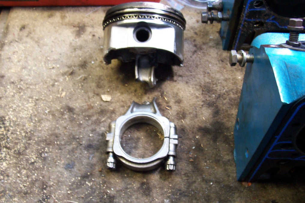

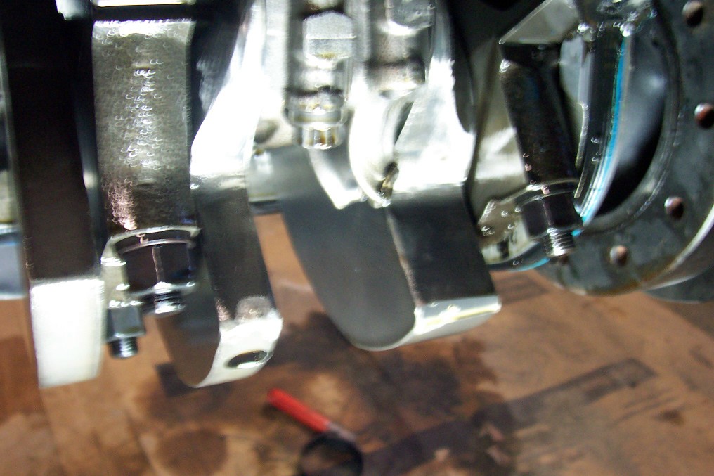

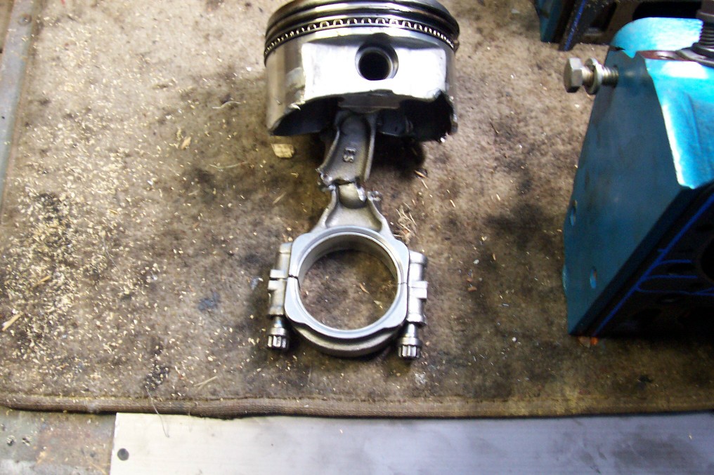

Actually, I put it together. I had a machine shop balance the rotating assembly. I had the car on a chassis dyno a month before this happened and it did well. I've never seen a rod fail like this. I have seen rod cap bolts fail and send rods out the side of a block, but never saw a rod bust in half...till today.
Now it makes me wonder if I should just replace the one rod and trust the rest of them or not.....
EDIT - Well, I took off the heads, and the block looks like it survived at least...I'll have to pull the cam out and see if it can be polished or something. Looks like it got scraped right on the top of one lobe. I also got the piston out too and it's shot. I'll post up a pic of the busted piston and rod together for everyone's amusement....

Why not give yourself some " insurance " since you're going to rebuild, give it the WHOLE once-over so you don't end -up with a HOLE in the pan or block??
Too much $ to take a chance. Who knows what kind of recoil the other rods went thru, or if some bearing surfaces got scuffed.
I've seen 2 rods end up like that.
1 was in a tunnel rammed smblock that was started on eather--talk about a 0-7500RPM in a second!!
The other was from a 468 Bigblock that had a nitrous mishap.

If you're going to throw a rod, it usually happens where yours did. On the journal farthest from the oil pump.

Show the shop what you found. Let them offer to pay for it. If they don't offer, insist they do.
BTW, it looks like that broken rod end banged on something. Might want to make sure whatever that was isn't also damaged beyond repair. I, too, would recommend a complete tear-down and full inspection, including Magnaflux.

Anyways, here's a couple pics of the piston/rod after removal. There was a small hole in the oil pan and one cam lobe is does indeed have a flat scuff mark near the top of one lobe. Everything else in the engine looks brand new.
Attached Thumbnails How's this for engine damage???-102_0586.jpg   How's this for engine damage???-102_0587.jpg

Any signs of rust in that cylinder?

Rust? - No, no rust anywhere.

IRT the rod breakage. I have a problem with this.
A 200K mile stock rod with ten holes drilled in the beam and loose bolts could not have broken like that on a start-up, even with backfires.
AFAIK the only way to cause a rod like that to bend there is either a physical binding like dropped valve or hydrolock, severe detonation, which both would have also damaged the piston, or an over-rev.
I'm not saying there is no other option, but I have yet to learn of them.
Also, keep in mind that an engine can be destroyed by an over-rev without putting any miles on it. I think the rev limiter is the best option.
If I were the shop owner and I saw that rod damage, I would be talking seriously to my employees, and I would offer some compensation.
edit: There is also the possibility that the rod was bent when you dropped it off and it just took a while to crack in two.

^^ x2. Does the top of the piston indicate any damage (such as contact with a valve or indication of detonation)?? It either hit something (valve, head, foreign object), was over revved, or was a bad rod to begin with.
Keep in mind that frequent high rpm can fatigue rods that are not designed for it, eventually causing them to break.

im tired of everything getting blamed on chineese stuff... if thats the case then everyone better take back their camrys, nissans, toyotas etc.. theu are all forgein too!
i agree, somthing made contact.. seems like a valve by the way he describes the cam lobe being flat... would be suprised if the lifter and pushrod are damaged as well....
check everything with a fine tooth comb before reassembly, wash wash wash, and wash again until spot less, cause i am sure some metal went places it wasn't suppose to when that happend..
and i agree also with the taking better care of customers cars.... which is why i am having my ta painted before the engine goes in.. no way am i leaving a 500hp 350 in the hands of some local yokle to see how much power it has... and i always check my milage before droping anything off, better safe than sorry...
id see an attorney if i were you and explain the situation.... i think someone had fun with ya ride my good man...

Do rods, Chinese or not, really just suddenly disintegrate like that from normal use? It seems like it's really pointing towards some high rpm failure at first glance to me, but Ive never thrown a rod yet, so I dont have much experience with it.
InfernalVortex: Well, I don't have experience either with a rod breaking in half. I myself have only driven it up to 5500 RPM's and one other time I saw it at 6K RPM's - once - on the chassis dyno.
305sbc: That's EXACTLY why I have not outright accused the shop of wrong doing. I can get all the attorney's I can afford, and I still can't PROVE anything. So what good would it really do to raise h*ll with the shop at this point? You can bet that if I had proof this damage was due to their negligence, they'd be paying for it.
i agree, somthing made contact.. seems like a valve by the way he describes the cam lobe being flat... would be suprised if the lifter and pushrod are damaged as well....check everything with a fine tooth comb before reassembly, wash wash wash, and wash again until spot less, cause i am sure some metal went places it wasn't suppose to when that happend..
badgta:Nothing made contact that I can see. I suspect the cam lobe was damaged by the rod cap nut as the crank spun around. Almost half the nut was ground off. With the rod broke like it was, that rod was kinda "out of synch" which allowed the rod cap bolt to make contact with the cam lobe. The lower part of that rod also put a hole in the oil pan right behind the fuel pump. Amazingly enough, there were only a few small chunks of the rod I found in the bottom of the pan - no shavings at all, all lifters etc. OK.

Any chance this was hydro lock? Not sure of your complete set-up, but a leaking injector could flood a cylinder.

I wish it was almost...at least it would explain why the rod busted. But no, I don't think it was since there was no trace of water in the cylinder or in the oil - I looked closely at the oil as it drained. It's a carbed car, so no leaking injectors to worry about.
I do know the car backfired badly on me once after I had first installed the blower. Sounded like a shotgun went off - and I'm not exaggerating. Funny thing is, I had it on the dyno afterwards and it did fine and i drove it for a month afterwards with no issues. Heck, I even met up with the Power Tour for a stint. I may never know for sure...
I agree that the right thing to do would be to do a total teardown again, have everything magnafluxed and rebuild from there, but I opened up this engine again and everything else looks pristine...and I've been looking hard for any signs of stress on the remaining rods, pistons etc. - and it looks as new as when it went together. Still had good oil pressure when it was clanking from the busted rod. I can read all the P/N's on the actual parts still!
I know I'm taking a chance, but I think I'll try replacing the piston, rod, bearing and oil pan and watch it closely after I start it for water leaking into the oil, etc. and let it go for a few startup and shutdown (heat cycles) and hope it's OK. I guess if I blow another rod and it goes through the block - time for a Motown block then! I've spent enough $$ on this .040 over 400 already...more than it's worth.

I see marks on that crank in your first pictures. I'm not sure I would ignore that. Did you say also that the cam had a mark on it?
A GM dealer (out of business, what a shock) was nice enough to take my car out for a 'test drive' after they repaired a sheared off wrist pin (not joking) and proceeded to overheat the car, and on top of that THEY threw a rod. Didn't tell me about that little detail, of course. They patched it up by replacing presumably just the one rod and maybe a piston, but left the camshaft in place. Well...... that cam was cracked. Ever since it was repaired, the engine had a tick. They blamed it on a lifter, and refused to fix it. 20k miles later that cracked cam finally broke, and sent a rod out the side of the pan.
I would highly advise either checking each part closely (including the previously mentioned magnaflux although that isnt perfect either) and replacing anything questionable. Otherwise, you're more than likely just going to be in there again.
Naw, those marks are fine. The whole rotating assy. was balanced at the shop. That's probably what you see on the crank. But yeah, one lobe on the cam has a tiny bit of a flat spot worn in on the decending ramp. I have to replace the whole cam because of that tiny spot unfortunatly.

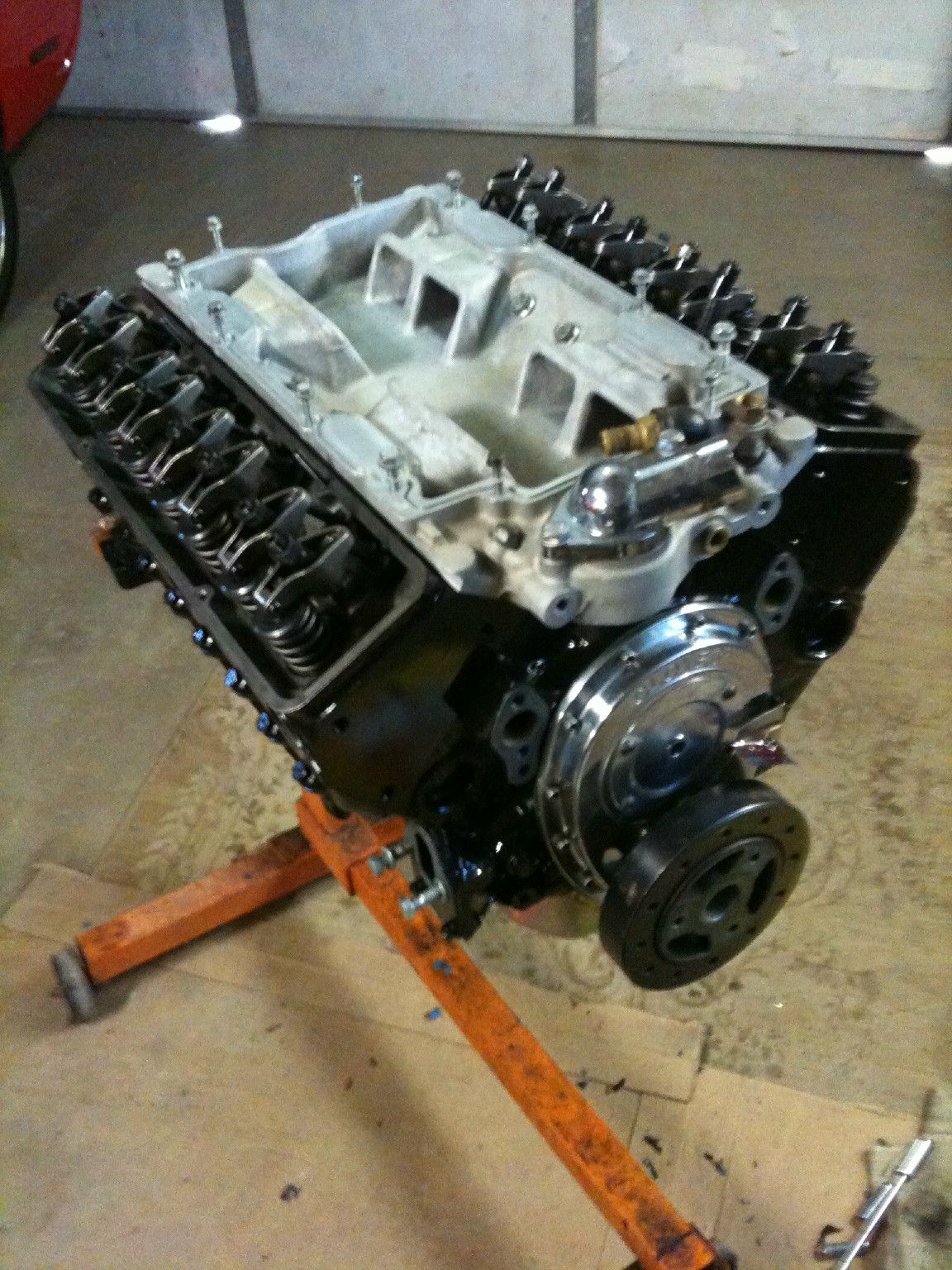

I decided this puppy is going back together. I have a new piston, rod and bearing along with all the gaskets to put it back together. They are at the shop along with the rod and piston from a good cylinder so they can be balanced. I still need to buy a new cam and I'm trying to decide if I want to run the same grind or something different.
This time, I decided to run MLS head gaskets. The machine shop recommended I run those with boost. (I didn't know that the first time)...

I had a Manly rod let go in 2002. I was just idling through my neighborhood. 427 SBC build. It ruined my bowtie block and took out the oil pan, piston and cam. It looked just like that. The rod had a void in it. I had never seen anything like it. Manly offered a new set of rods but that was all. I was idling when it happened.
Was extremely hard to explain to the wife that my 8000 dollar motor just retired after one drive and I needed her to help me tow it back to the garage a block from home.
I don't think there was foul play here. That looks like a manufacturing defect in the rod. THe force it would take to do that to a healthy rod would be un believeable, and would most likely result in cylinder damage.

Well, it's been a couple of months, but I've been busy with the Camaro. Engine is almost together again. Can't wait to get her started and running!!
If I'm lucky, I might have everything put back together before Thirdgenfest comes around.
By far, the cam was the most expensive thing that was damaged. Of course, while any engine is this far torn down, you end up buying more stuff to either make it look better or perform better....Oh..and I decided to paint the engine black again. It shows off chrome and billet parts better, but it's a bit tougher to find oil leaks. That won't be a problem since I'll have no leaks...lol
EDIT: Oooops...How'd that Dodge get in there?
