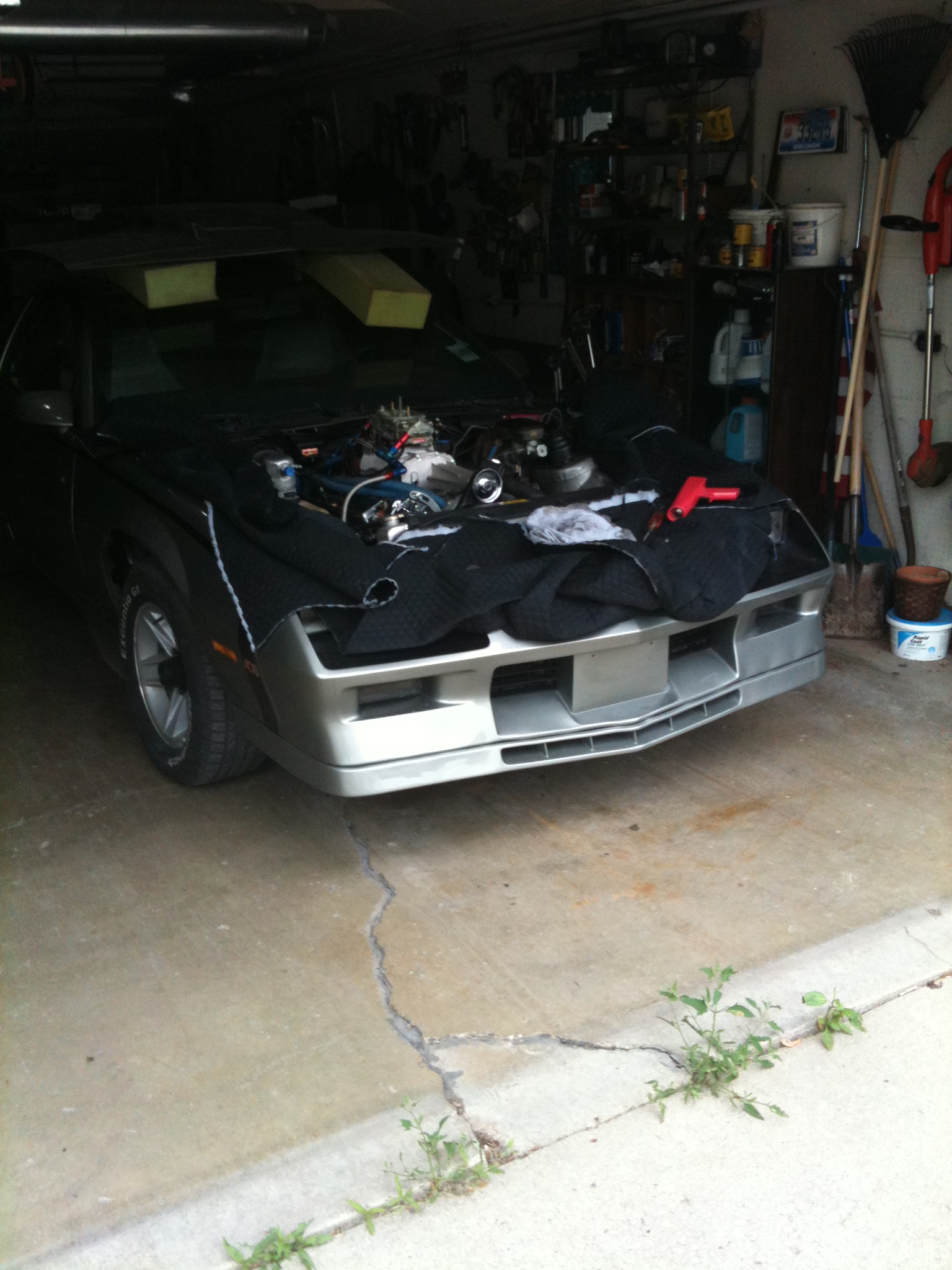

Engine is ready to drop in now. Should have it running next week!

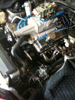

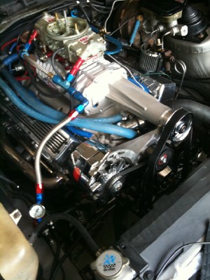

Well, as of today it's finally ALIVE!!!
Just got it running and waiting on it to cool down a bit so I can tinker with it a little, but it may not take much. It's idling pretty smooth at 750 RPM's and the best news - No leaks whatsoever (for now)
Still need to get the hood on along with a few minor things, and I'll need to limp it to an exhaust shop for it's first road trip since my Y-pipe needs to be modded to work with the new oil pan I have on it.
I have it jury rigged to get me there, but amazingly it's quiter than it used to be...I apparently have always had leaks in the past and didn't realize it. I was a bit suprised on how easy it was to get it started....my timing was set at 40 degrees advanced and it still ran without any backfire...I now have it set at 14 degrees BTDC, plus the 22 degrees mechanical should max me at 36 degrees in by 2500. A few pics of subject money pit...
