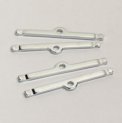

here's those valve cover hold downs

Re: found a 350!!!
tightened my valve cover today and got leaks!!!! AAAARRRGGGHHH!!!!
