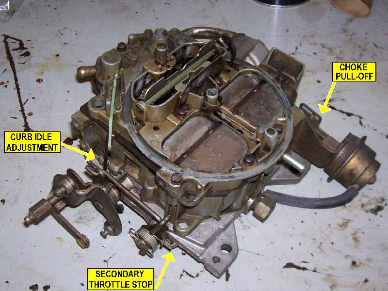

There is too much idle air for some reason and that needs to be reduced. Some easy things to do are:
Check the setting of the main idle speed screw;

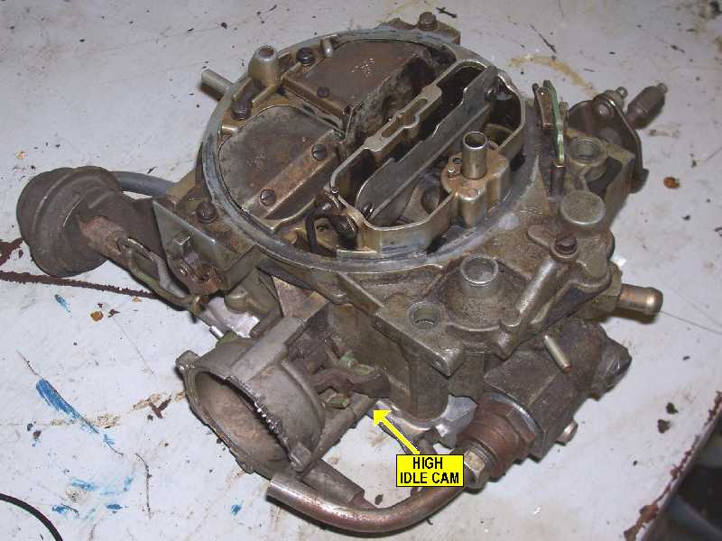

Make sure the high idle cam is completely clear of the high idle screw with the choke open;
Check for any vacuum leaks, including the EGR, PCV, brake booster, intake gaskets, and hoses;
Make sure the secondary throttle plates are closing fully;
Verify none of the throttle plates are sticking in their bores.
