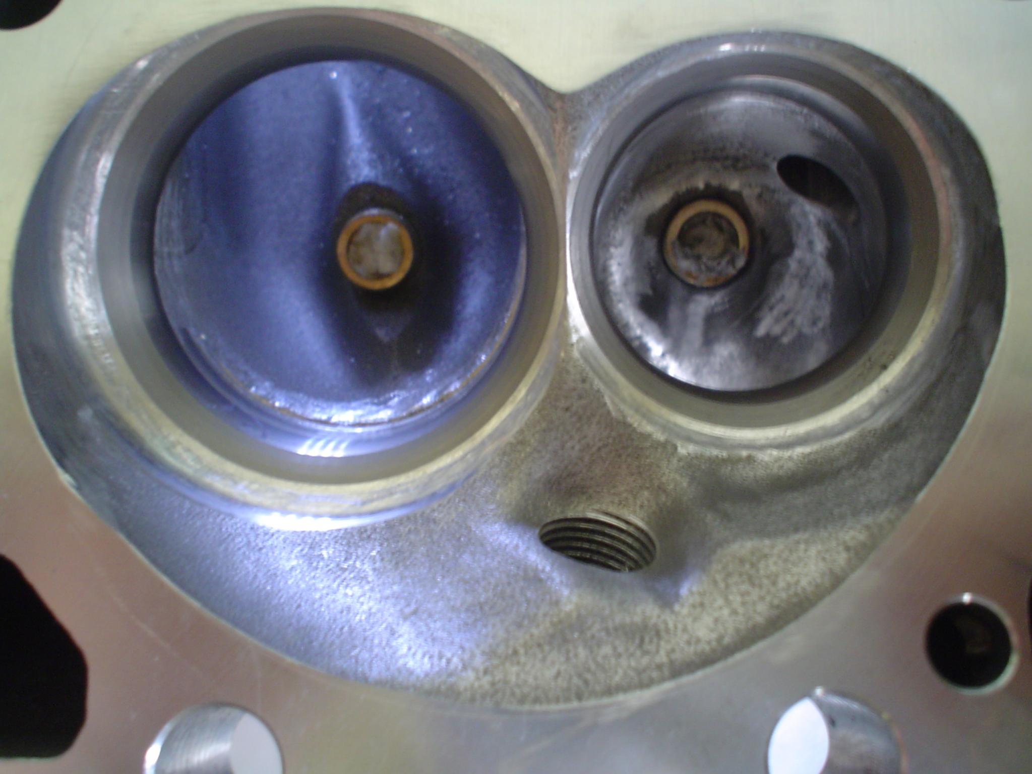

Grinding away the dumb machining ridges around the valves, was scary.
This is probably anough cleanup/grinding for me, did both heads, time to reassemble with comp cams valve springs.
Attached Thumbnails summitracing 170 heads clean up advise welcome-dsc08064.jpg   summitracing 170 heads clean up advise welcome-dsc08057.jpg

It's one of those things that if ever it doesn't intimidate you, you're too jaded. As it is, you're not ready for reassembly. I'm about to re-post your pic, this time with some colored outlines, so I can point out the issues. Plus you didn't polish the chambers.

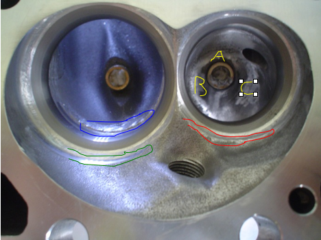

Re: summitracing 170 heads clean up advise welcome
In the blue circles, that's too ragged, you're creating too much turbulence, where it doesn't belong.
In the red, WTF?! You were supposed to be grinding that smooth.
In the green, we see that you didn't actually help the ridges enough to think about. Very 1/4-assed.
Yellow A = too rough. Yellow B = inconsistent. Yellow C = not done enough. Yellow D = Where's your polishing?
Tell ya what. Ship them to me, for $30 I'll make them right. Plus you pay shipping both ways.
I like your attitude
Thanks for the directions/advice, I couldent finde good porting tools locally, will do whats possible.
Appreciate your offer, but shipping alone will end up like a new set from summit.
Edit: Concerning "Yellow D", the whole exhaust port should be polished much more then I did, the combustion chamber can be polished too but does not need to be a mirror finish.
Attached Thumbnails summitracing 170 heads clean up advise welcome-sum-170-colored-outlines.png
Last edited by thomas1976; Apr 14, 2013 at 09:28 AM. Reason: Add quote and reproduction of deleted pic

Okay.
Get a 4" mandrel and a bunch of 120 grit, 3/8" "tootsie rolls", and put the carbide away. First set aside 8 rolls for chamber work, and don't use them for anything else. Then re- gorilla tape the seats. Start with the exhaust ports, since they're easy. This'll give you a feel for what you're doing, and build your confidence.
From there, move on to the chambers. Start with the issues in the green and red outlines before moving on to polishing.
By this point, you should be good to address the intake ports. Those blue circles are in the long side, where minimal polishing won't hurt much. Just keep your rolls away from the short turns.

The cleanest I can get them.
Attached Thumbnails summitracing 170 heads clean up advise welcome-dsc08084.jpg   summitracing 170 heads clean up advise welcome-dsc08088.jpg   summitracing 170 heads clean up advise welcome-dsc08073.jpg

First, thank you for going back and doing better. Your intake port looks very good. What you did of the chamber looks good enough. What you did of the exhaust port is excellent, but it looks like you didn't even try polishing the guide boss. There's still another 10 cfm there. Go in through the valve seat.
Then you'll be done. Polishing is tedious, but depending on the rest of your combo, there's still up to 20 more free HP waiting for you to unlock. More than 30 if using a power adder, like nitrous or boost. Please go at it one more time, as just described. You can do it. I can tell by what you just posted.

The polish weel I found disintegrated in less then 10 minutes.
I find flap wheels and the polish wheels just about useless. You have to use some sort of lube (LW machine oil, WD40, ect) to make the wheels not tear up so fast, it helps polish too. They are so bulky and awkward though it's impossible to get them in the tight spots they need be.
Atilla is spot on about the cartridge rolls, running my grinder at 50% will shred a new one in seconds, while if the speed controller is turned down to 25% it will last for as long as it still has grit(at that time I trash it my self). I'm using an electric grinder with speed control. I don't know how you guys do it with air grinders; the first set I ported with one and I found it way more difficult to control then the elec one and most my focus was on controlling the tool and not the porting. (those percentages I'm quoting I don't think they in relation to 0-100% duty since my dial doesn't go to 0%, it's a percentage of where the dial is in it's range)

I've tried polishing with WD40, it makes the same job take 4 times as long. WD40 is great lubricant for porting aluminum, but I polish dry. And my rolls never shred. The far ends usually wear away, turning a cylinder shape into a cone shape, but that's mostly because of what I'm doing, not bad rolls. The rolls last for hours unless I'm doing sharp edges. Running the rolls too fast or too slow leads to bent or broken mandrels, also called arbors.

The sharp edges do make a huge difference I always run slower in the bowls, port openings, ect then in the common wall floor area. I can run the bigger rolls quiet fast in that area actually.
Yeah they don't actually "shred" (just using colorful language) they come unrolled at speed for me. That's both with the SA porting kit rolls and the brand from the local industrial supply store.
I do like different rolls for different parts of the heads. The one's I use most though are the thin cylinder shaped (look exactly like the pictured one in Atilla's head porting thread), and a shorter wider tapered roll.

Little update, I had the engine out due to oil pressure dropping under acceleration, short story, the oil pump pickup came off and was laying in the oil pan.
Inspecting the heads I found burned oil in the combustion chamber and on the top of the valves, so I decided to change the valve seals + valve locks and PCV + rubber grommets.
Valve locks part # TFS-51400444 (7 degree for 11/32 in. Valve Stem, the black ones in the pics)
Valve seals part # TFS-30400454 (0.500 I.D. for 11/32 in. Valve Stem, the blue ones in the pics)
The old Valve Locks were really stubborn to get out ouf the Retainers, I had to use the following technique to break them loose
(at around 4 minutes)
