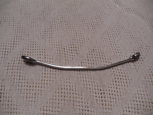

Last night I decided to tackle the motor mounts in my '84 T/A. After swearing and sweating for three hours under the car, I had the driver's sound mount out and absolutely zero patience to continue.
I searched around the board today and found suggestions ranging from deal with it to cut the K member and weld it back up. Someone (dunno who) mentioned bending a cheapo 15mm wrench and using it, and that's exactly what I did.
I started out with a trip to Harbor Freight to buy these:
http://www.harborfreight.com/11-piec...set-47067.html
Then, with a vice and a sledge hammer I modified the 15mm wrench. It worked AWESOME. Like I said, it took three hours to disassemble the driver's side, but tonight with the bent up wrench I got the driver's side reassembled and the passenger side totally done and back on the ground in about 1.5 hours.
The extra long handle was critical, it made the whole operation a snap. Highly recommended!

I got just the one wrench from Auto Zone and it only has one bend in it. Easy $5.99 solution. Proof that great minds think alike...
