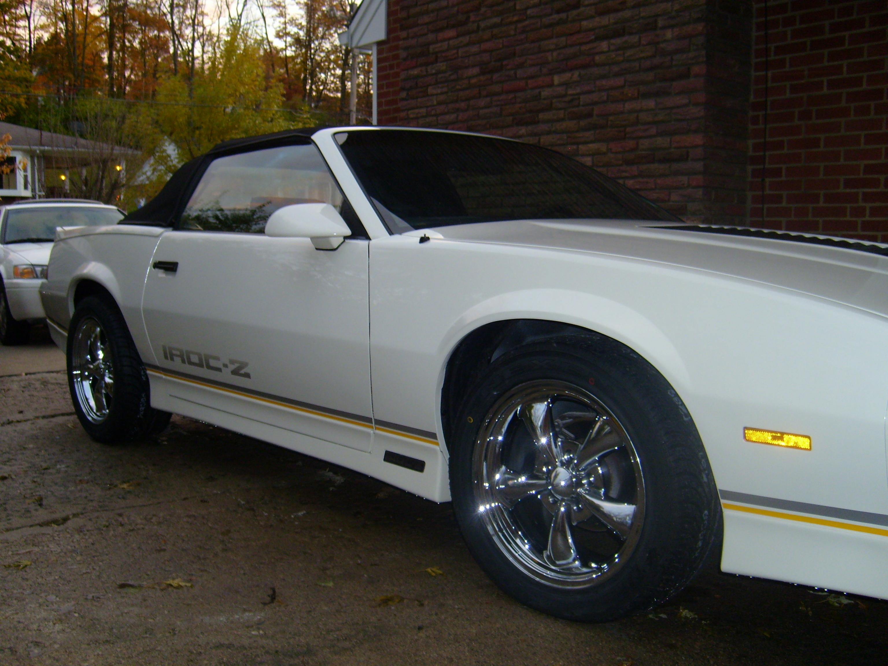

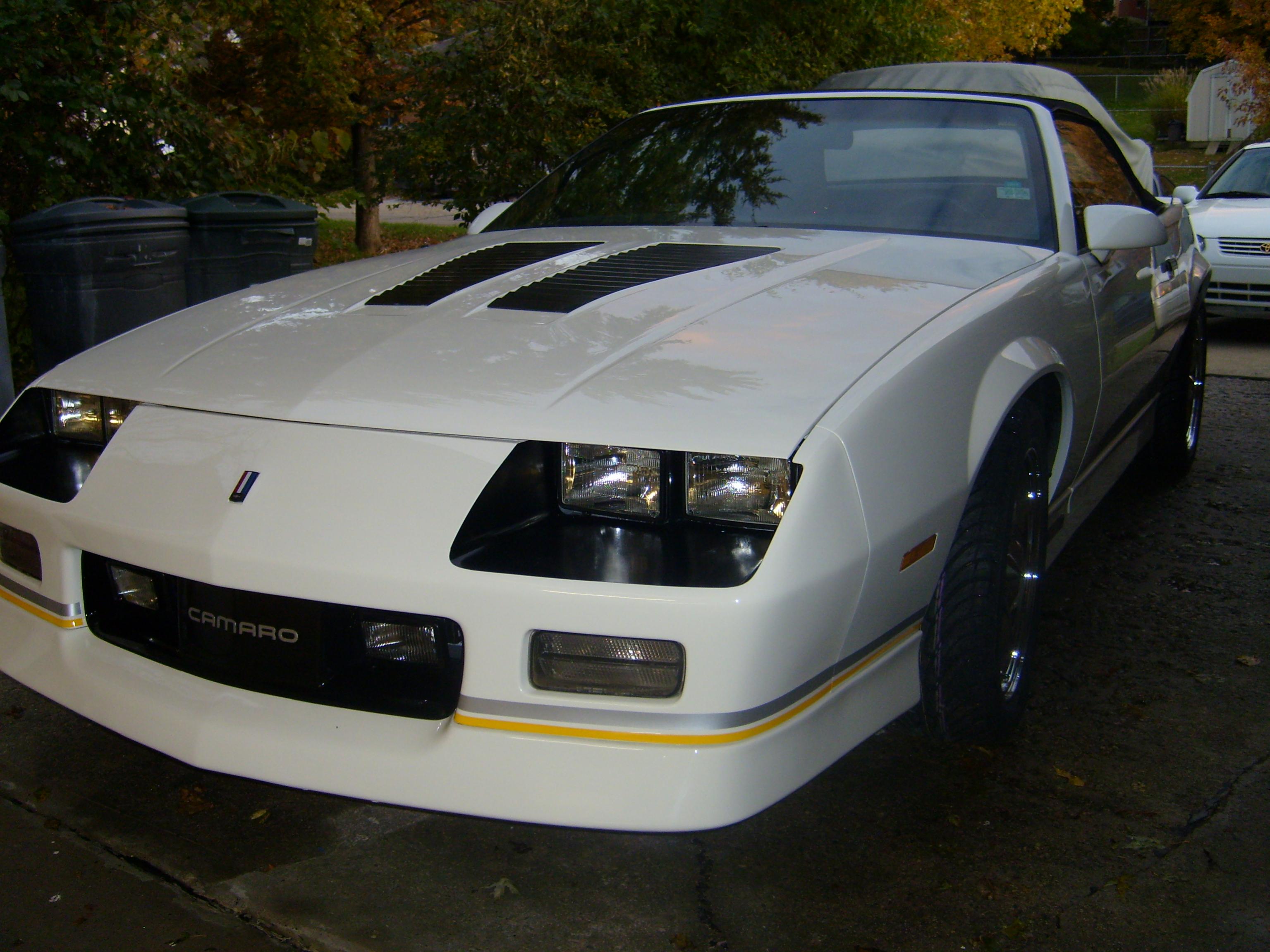

Guys thanks for the help, but after many hours of work on this car and many $$$ I AND my finace nave come to the conclusion we will NEVER own another Chevrolet product ever again! I have always owned Ford products and in fact I have a 2007 F-150 and a 2006 Fusion in my drive as I type this message. I HAVE NEVER HAD A MAJOR PROBLEM OUT OF MY FORDS AND WITH THIS ISSUE I AM DONE WITH CHEVY. Good luck to you all. The car is for sale: 1989 Camaro convertible all original with 62000k on it. I bought it from the original owners and restored it. I have many hours into it and Is has alot of new parts. Interior is mint. I am aking $12000 OBO - pics included
