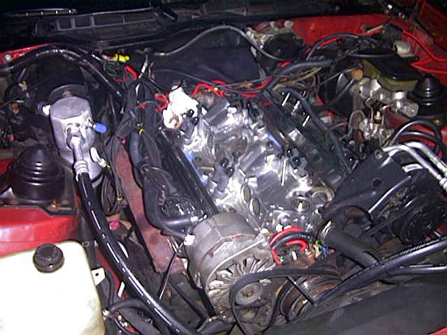

Is this a roller engine?
Just wanting to know if this engine has roller lifters?
Thanks!

yeah it is a roller motor you can tell from the hold down spider in the middle of it, flat tappet hydraulic cams don't use that. You are posting in the wrong section though this will more than likely get moved.

Its ok if it gets moved, Both of you gave me the answer that I needed to know! Thank-you for the info!!!

And clean that coolant out of your oil.

Getting it reassembled now.
