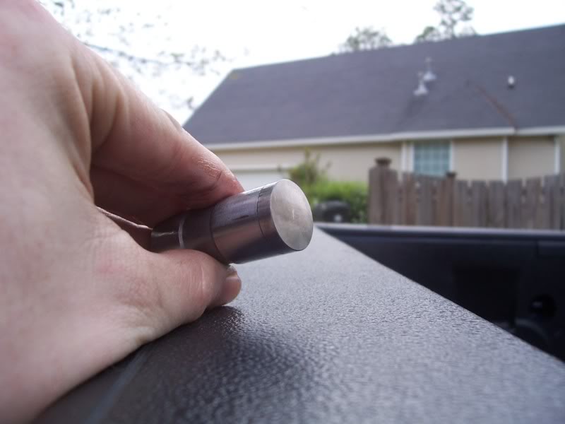

I would recommend you skimp on heads or intake before you skimp on the cam. Get a roller cam, if you're not glad you did later, it's only because you dont know what you missed out on.
Maybe Im just paranoid with my car, but running all the additives and worrying about lobes getting wiped due to shitty modern oil formulations, not to mention the headache of doing the cam break in and just hoping for hte best, plus the gradual wear of the lobes and small metal shavings workign their way through your engine/oil for the life of the engine... all of these make me wish I had a roller cam. And then if you lose one lifter, you'll prob have to replace the cam and all the lifters. Flat tappet lobes and lifters are so finnicky and picky. Even under perfect conditions you're not guaranteed that they will work.
That said, mine went through hell trying to get it broken in. Break in didnt go well for it at all... it was stretched over 3 different sessions and I had some serious issues every time I tried, and it ended up only getting 15 minutes of break in time on it when it was all said and done, but it survived. But I attribute that to me putting cam lube on the lifters after each attempted break in session. I had to keep tearing it down, and I was gonna do everything I could to stack the odds in my favor while I was in it, so the lobes got relubricated. One of them had some ugly wear patterns on it after a few minutes of runtime, but ended up working out okay. But I still get the feeling you're somewhat playing Russian Roulette when it comes to flat tappet cams these days. I run 10-30 synthetic with break in additive as my day to day oil. Additive is $10 a bottle.
I dont regret going flat tappet, it's all I could afford, but if I had to do it again I'd use regular run of the mill 083 heads instead of my Vortecs and spend the extra moeny for a roller cam setup. It's easier to change heads than a cam in my opinion, and roller cams make more power everywhere.
