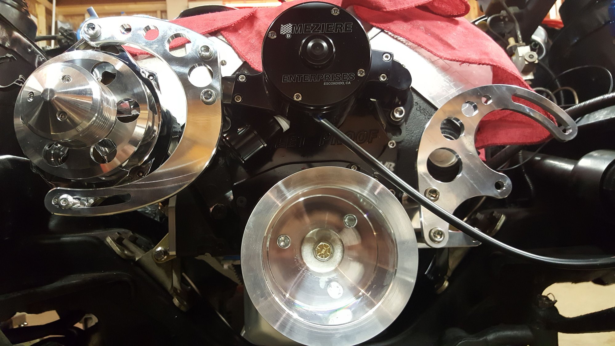

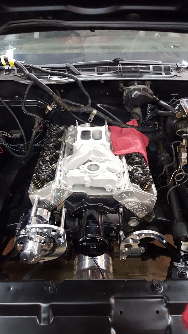

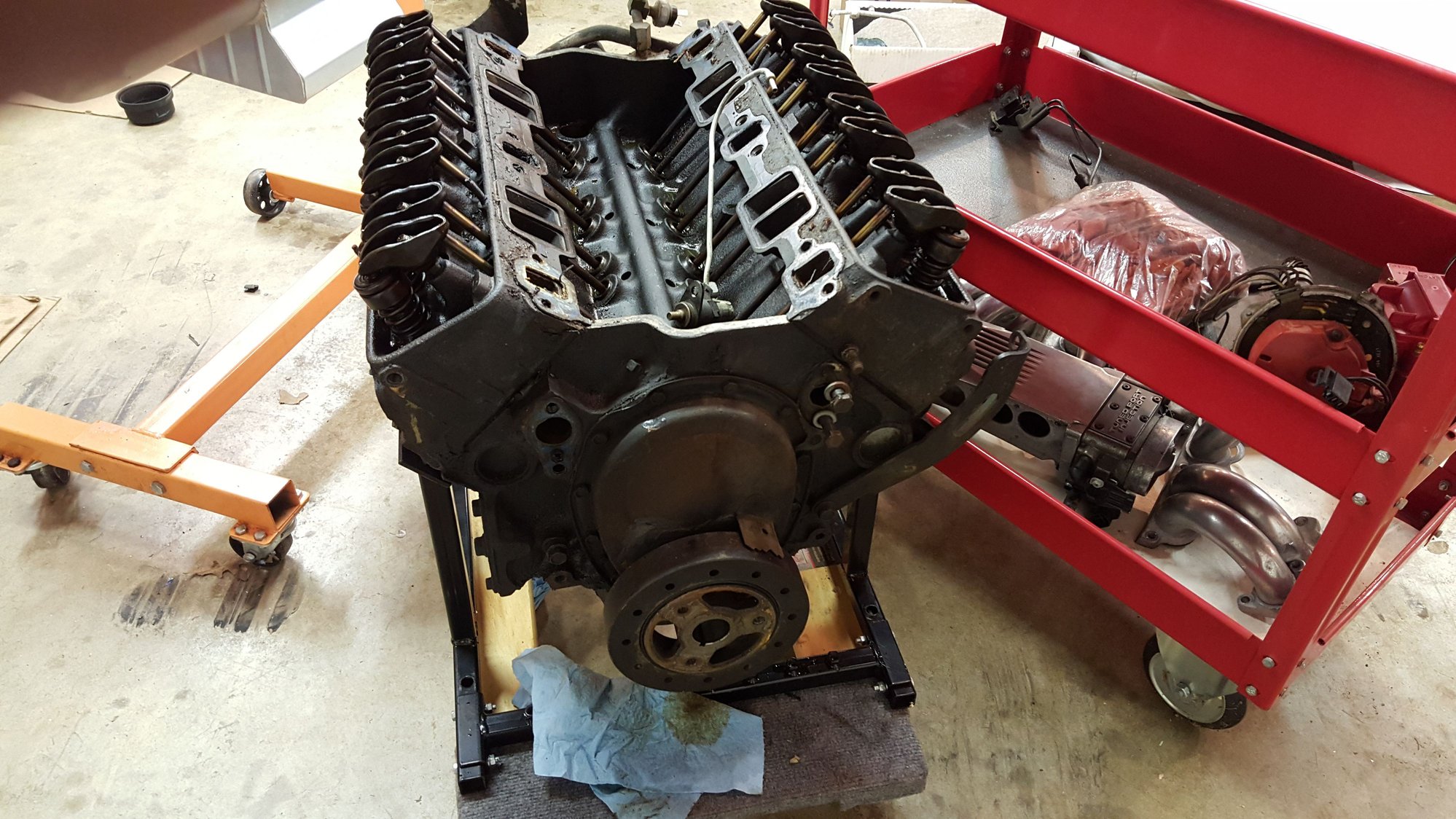

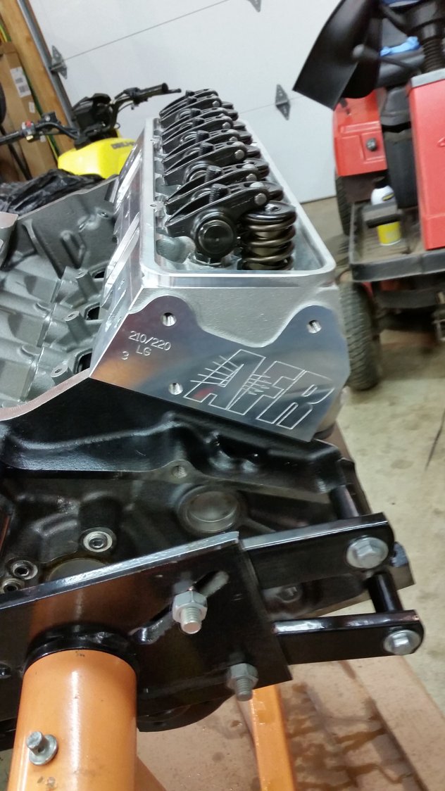

Finally managed to get some pics of the motor!

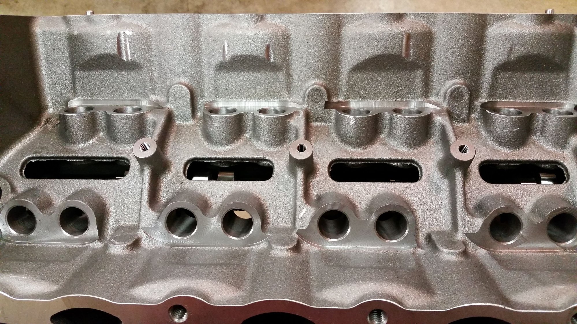

Happy to say, the UPS guys been 'round my place quite a bit recently lol I'm finally starting to appreciate how much money goes into a decent motor.. :/
-AFR 220 75cc race ported aluminum heads
-Comp pro magnum 1.6 roller rockers
-ARP rocker studs
-Manle head bolts
-7.3" Pushrods from Trend Products, apparently they're the same company that produce Diamond pistons, have been told they are as reliable as any diamond rod for a little drop in price. We shall see lol

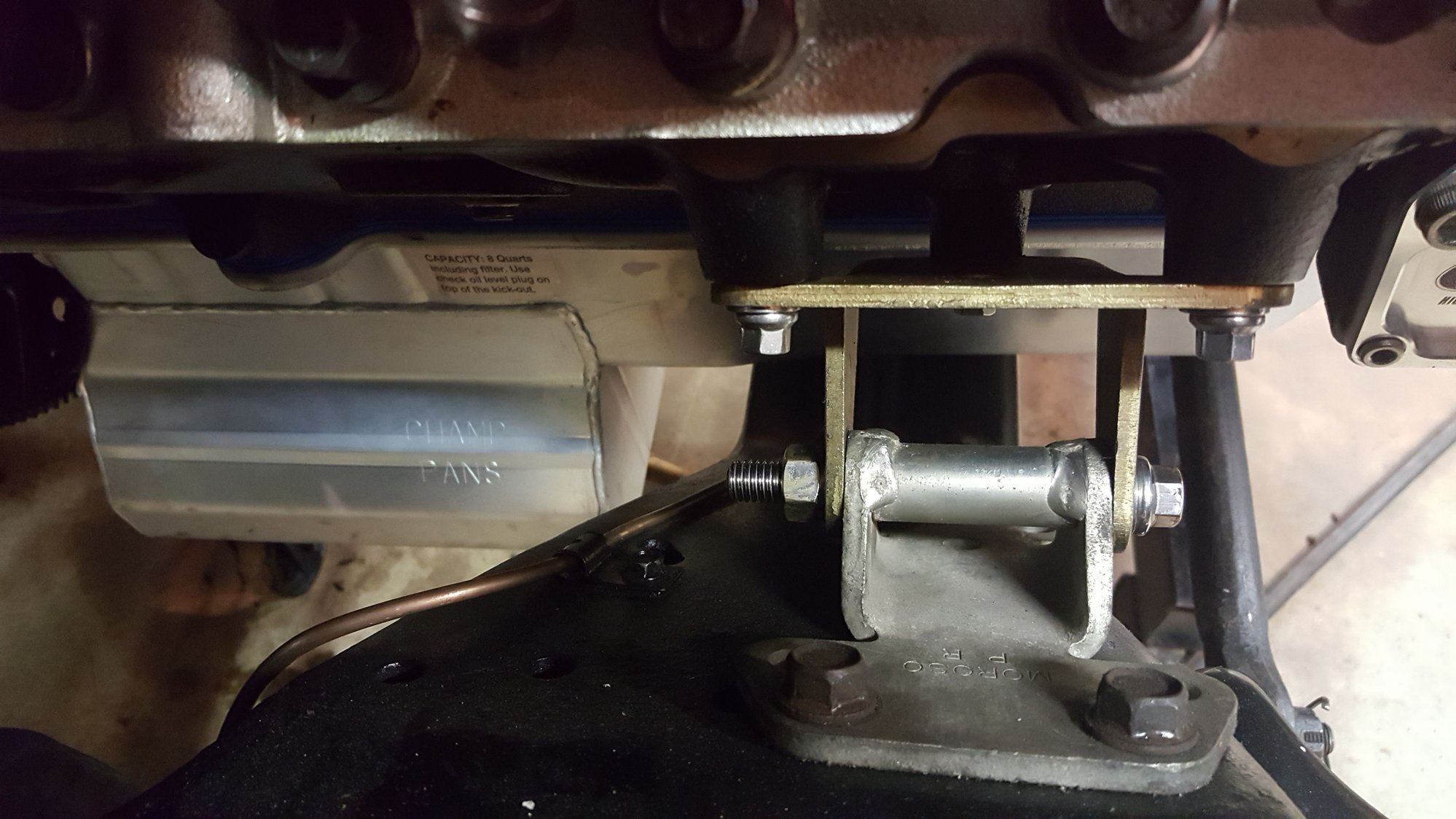

So I'm planning on ordering a pan to seal up the bottom end sometime this week, as well as the oil system. What works better as far as gaskets vs RTV sealer on an oil pan?

Check out the Fel Pro one piece oil pan gaskets. I've used them on 3 engines and love them.

Do they make one that has a hole bored out in the gasket for a stroker motor? I've been told that I would need a stroker specific gasket for my setup.
What hole would it need?? Are your pan rails notched out at all?

I can't speak to how it fits a 427, but my 383 (350 bored and stroked) had no fitment issues at all with this gasket.

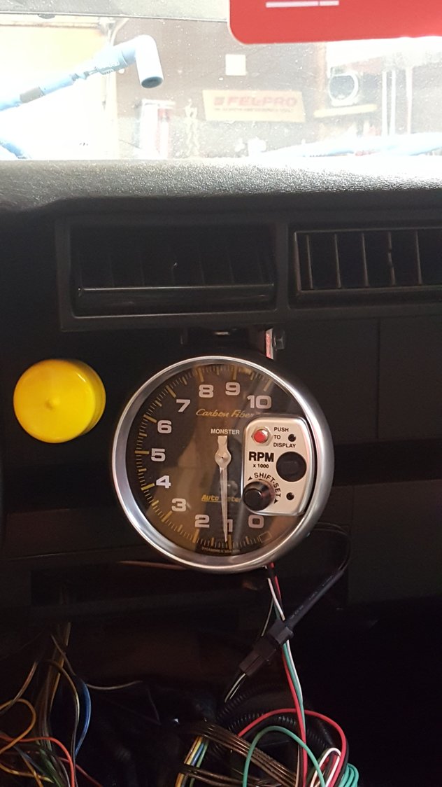

Old Mar 31, 2016 | 10:38 PM
Loudnproud86's Avatar
Joined: May 2013
Posts: 27
From: IL
Car: 86 IROC Z
Transmission: Rebuilt T5 5 speed
Axle/Gears: 10 Bolt 3.73 gear
Re: Goodbye 305.. and hello 427!

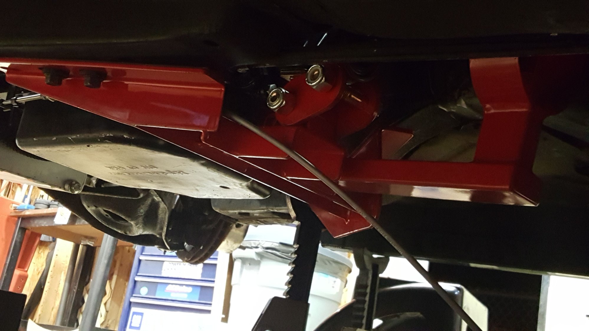

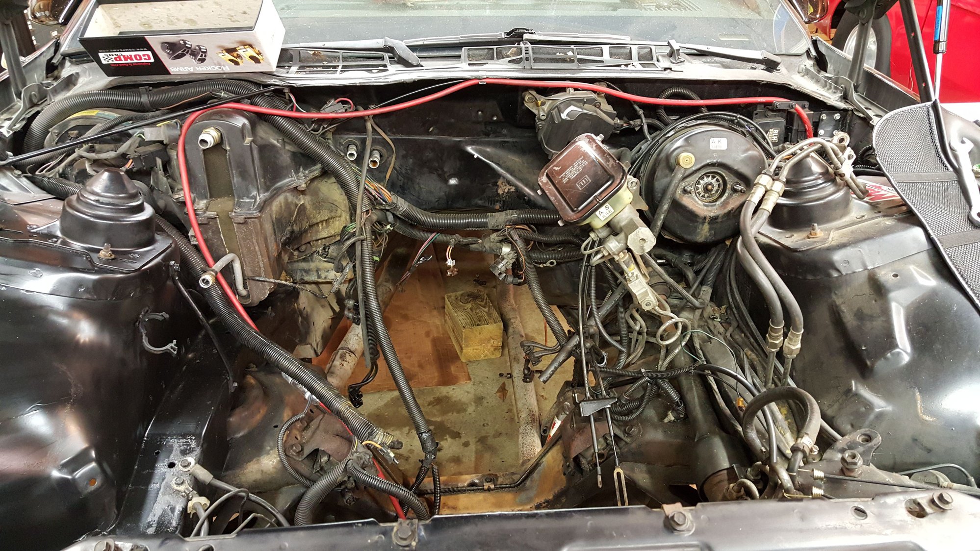

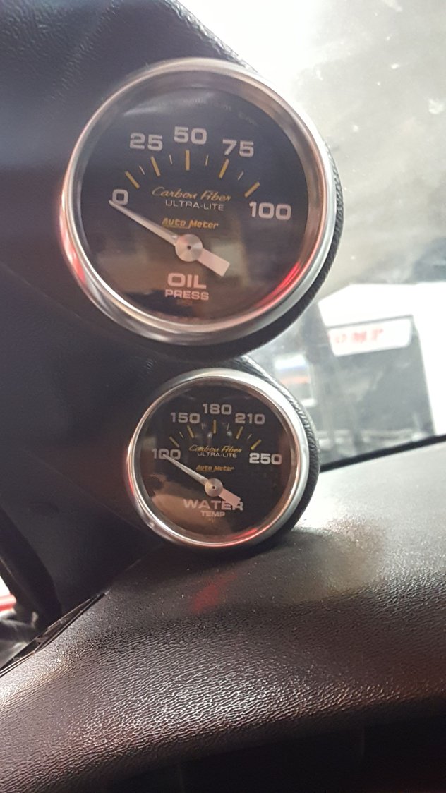

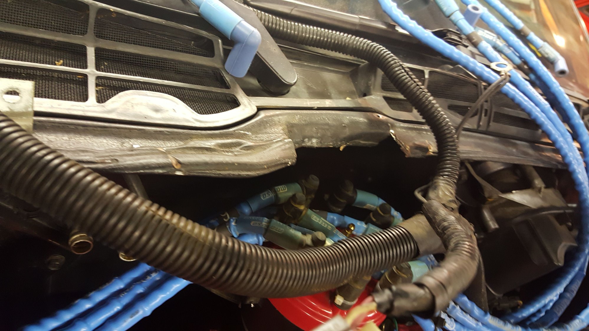

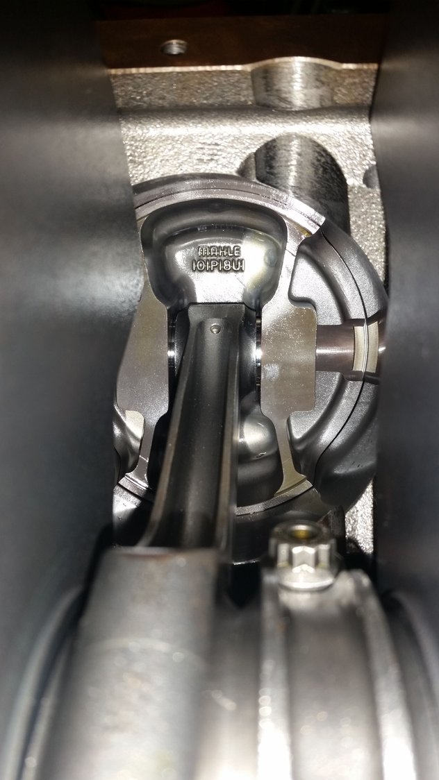

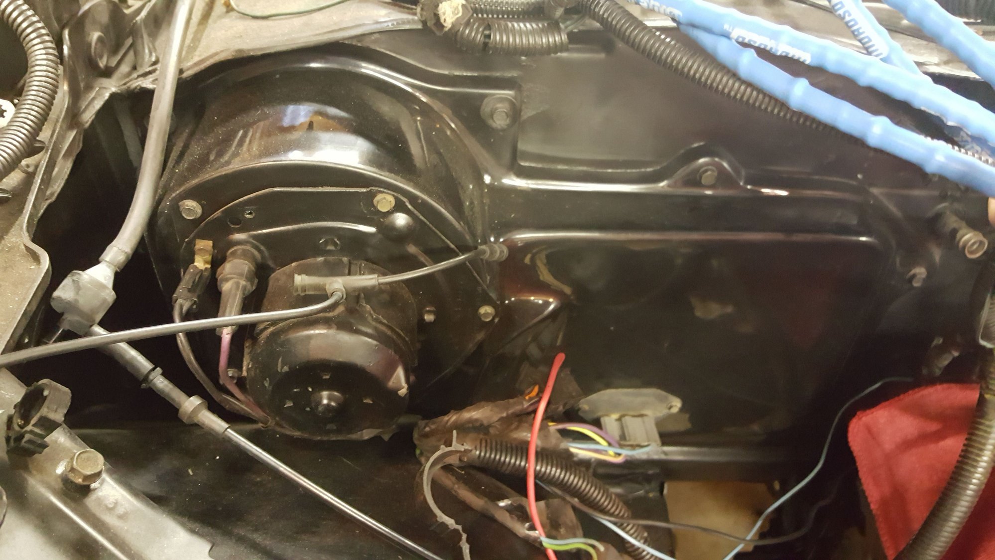

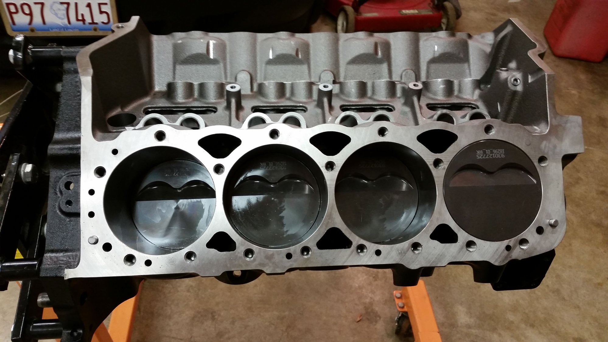

Haven't had much time to post between juggling the car, school, and work. But here's some photos of the progress so far. Got around to pulling the 305 beauty out as well lol.
Now begins the painful process of cleaning up the engine bay. Figuring which harnesses to keep and which to eliminate mostly. Since im switching from TPI to carbureted, I know a lot can go. Any insight to that would be helpful (:
Plans for a trans is an ATI turbo 400 with reverse manual valve body. And as for the rear end.. well if it's good to roll and it's warm out the 10 bolt may be in for a little spin.

You putting the spider back in?

Is this the Dart 427 forged short block kit from Skip White? It looks great and I plan to follow you through your build. I hope to build the same engine next fall and winter. Great choice of cylinder heads.
I know right? (: I sat and stared at that pretty aluminum headwork for hours when they came. Got them for a steal too from my engine builder. And it's actually a Dart SHP Block, which is a factory style bow tie block that's been Remachined, rehoned, and stroked from a 350 block to a 427.

Originally Posted by Loudnproud86
By the spider do you mean the ring and pinion in the diff? If so then I was planning on it till I can afford a full rear end upgrade.
No, I think he means the spider plate that holds the lifter dog bones down in the lifter valley.
Ah I see. No I just ordered the comp cam installation kit from summit. Came with the spider tray and the dog bones.

Old Jul 14, 2016 | 12:32 AM
Joined: May 2013
Posts: 27
From: IL
Car: 86 IROC Z
Hey guys, just an update so far on how the build is coming along.
-Finished cleaning up and painting the engine bay.
-Installed an A/C delete panel for a cleaner look, and wanted to keep heat for the fall
-gutted main harness and ecm from passenger side fenderwell
-solid motor mounts from my buddies third gen
-reinstalled control arms and springs (almost died from a spring to the face, so coilovers asap lol)
Old Jul 14, 2016 | 12:40 AM
Joined: May 2013
Posts: 27
From: IL
Car: 86 IROC Z
-got a fresh T400 from ATI racing delivered. Good up to 800hp with a reverse manual valve body and a transbrake wired in.
-168 tooth flywheel 0 balance
-B&M 3600 stall converter
-bolted on front accessory drive to motor, (went with a serpentine conversion kit from CVF racing, came with all the brackets, pulleys, and hardware)
-threw the shiny new metal in the car and bolted her down
-running a Spohn tubular crossmember and torque arm in the rear
-realized the stock yoke was a wee bit too small so had to order a 1310 yoke from a local circle track shop down the street
-did some interior gauge work
-2 pod a pillar with carbon fiber series oil pressure and water temp
-carbon fiber series monster tach (i thought mounting it on the air box and reinserting the vents was clever imo lol)
