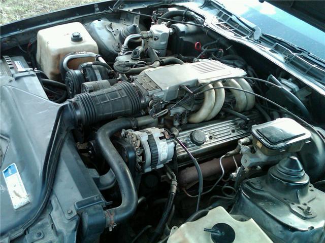

Ok, a TPI engine looks like this pic, and a TBI engine looks a lot closer to a carbureted engine, with air cleaner assembly on top.
Transmission...count your pedals, 3=standard(manual) tranny Gas, brake, and clutch... 2 pedals, gas and brake=automatic. Assuming that its stock, auto trans in your case would be a 700R4.
As far as a cam...honestly you need to learn a lot more about mechanics in general before you go buying a cam.
Why dont you show a few pics of the car. And look at the 8th digit in your vin, that will tell you if you have a 305 or 350 (if its a v8 anyway)

i got all the rpo codes and i decoded the vin number i did everything expect i couldnt figure how to use the engine codes
