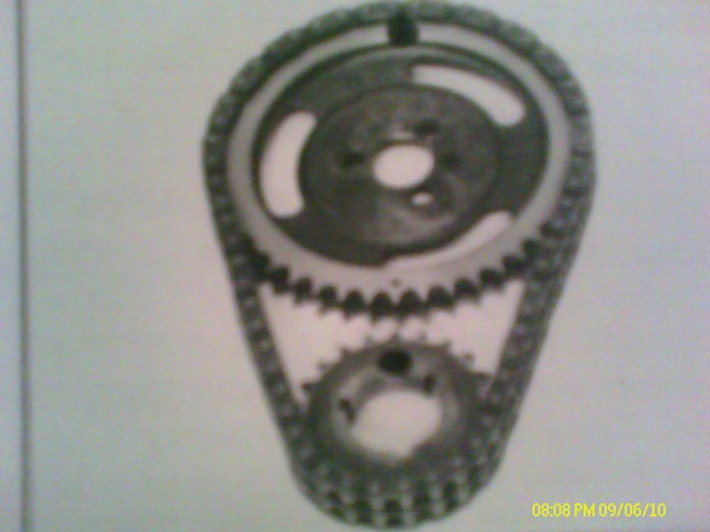

Thats because when the marks are dot to dot it is in the # 6 fireing pos. To get to number one, the crank gear dot is at 12 oclock as is the cam gear. Not dot to dot.
You want to get them like in the photo. Look at the black dots I marked in the photo thats what you want. Even in the chilton manual will tell you that both marks need to be at 12 oclock

Re: HELP CANT GET TIMING RIGHT?????????
You may of put in the dizzy 180*. Just try it. Loosen up the dizzy hold down bolt, slide the holder back, lift dizzy straight up about 1-2 inches, turn the rotor 180*. Make sure you clear the slot in the oil pump shaft because it won't sit correctly if you turn the input shaft in the oil pump. Let me tell you. I was skeptical when our own member "Chevy8588" told me to turn 180* after I told him that my IROC wouldn't start. I told him it was backfiring out the intake and he said "I know what the problem is." So I tried it and there it was. We had put the dizzy in half out when I switched to a 1994 Z-28 LT1 cam.
If you do make a "12 o'clock" adjustment, I would strongly advise that you turn the crank with a wrench just to be sure that the timing marks line up. I would hate to find out that the marks don't line up after you put the front of the engine back together.
