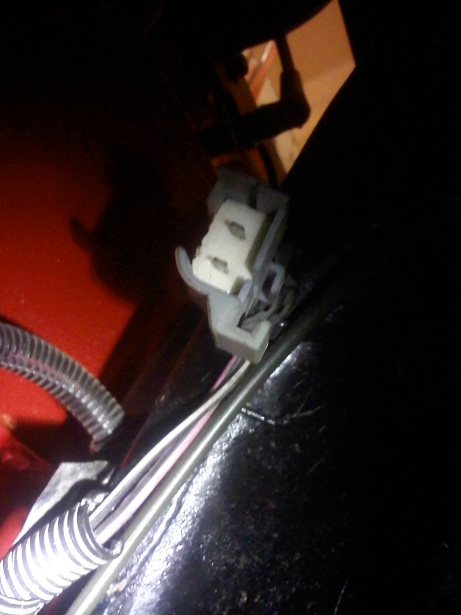

3. The wiring, i realize the way i have it is wrong. I need to hook it up to the ignition wires, which i believe is the connector with the Pink w/black stripe and Black w/ white stripe wires. However i am not certain. I know the dist needs 12v but needs to be switched from the ign. Where do i hook up my wires on the dist. to the car's harness?
4. Need it to spark will my 3 questions cause the spark? my grounds are good
Any info i would really appreciate. Also i will try to tag in a picture of the connector i believe to attach to the dist. Let me know if that is the correct connecter ( the pins are male)
Just reuse the IGN wire ( pink ? ) you had going to the Pos + terminal on coil in old points setup

Im so embarrassed to say this.. But i never connected the 3 prong connector to the cap. Here i am trying to find a harness that would connect up to the connector on the distributor body that is supposed to go to the cap.
Anyways its hooked up right now so i shouldnt have a problem there. I know i am at TDC. I took out the spark plug and put painters tape over the hole, turned it over till it made a loud pop and the tape flew off. Backed up the harmonic balancer to the 0 deg mark.
I just need to know where my ign wire is. I never had the points dist hooked up either. This entire car was completely ripped apart so idk where the ign wire is. I believe its the pink/blk wire that i posted a picture of in my last post.
6 years ive been waiting to hear this thing run and its all hopefully about trying to find that ign wire now. Any ideas?

The correct wire is a pink or pink with stripe wire with a second wire on that connector. I could not tell if it was what you tried showing. The pink wire is to the BAT terminal and the other (gray or white?) is to the TACH terminal.
If everything is right then it should run but rember that the tach will be reading to fast. 8 pulses to one revolution now as compared to the 6 per before so 900 will read as 1200 RPM's. Take what it is showing and divide by 4 then mult by 3. This is of course assuming that you have not changed the tach to a V8 tach.

The pink/blk wire was the right wire for the distributor. The other i do believe is the tach which i have not hooked up yet. I will be putting in all new gauges, the 145 mph gauge. Idk how much of a headache that will be to do. But i do not have the org v6 gauges anymore.
