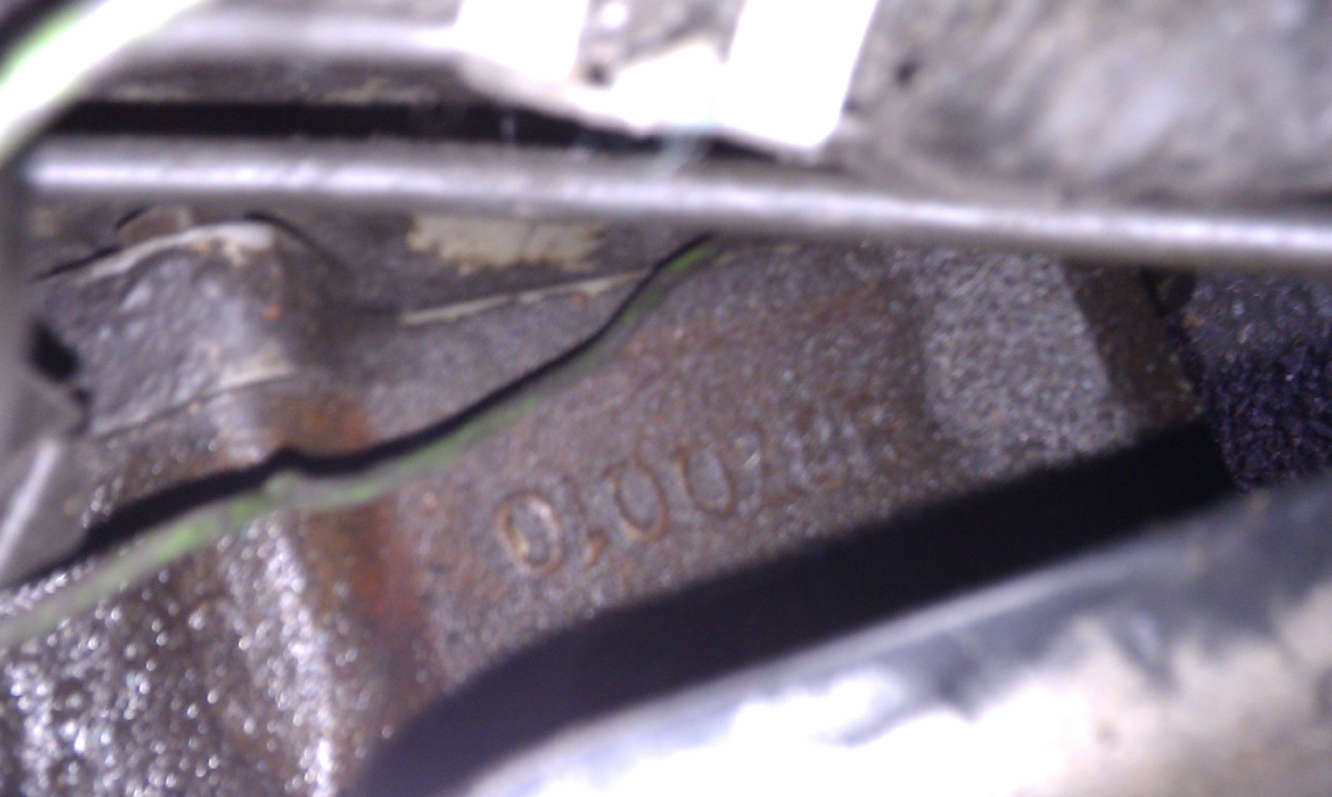

Hey guys, i've been looking around an i just wanna make sure what i got is what the internet is saying...always gotta double check. so this is what i found.
Heads casting : 462624
Block Casting: 8870010 or 3970010 (i'll post pic, hard to make out)
I've gotten mixed readings over these. The guy told me they were 2.02 heads and a 4 bolt main block. Let me know what you guys come up with.

The block casting is 3970010. It's the most common 1 piece RMS, 4" bore block cast, used in everything from trucks to Corvettes. They were finished with 2 bolt or 4 bolt mains, depending on the application. It really doesn't make any difference either way.
462624 heads are large chamber smog heads from the 70s, with lightweight castings that love to crack. Someone may have put 2.02 valves in them at some point, but they're still garbage.

Ape's correct. The block is fine, its just a generic 2pc seal block with 4" bore (302, 327, 350... 99% were 350ci). Its fine for an engine build. The heads are junk. Toss them. Low compression, crack prone, poor flowing even with big valves. Junk.
