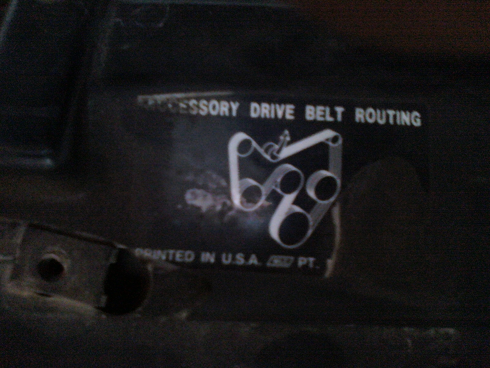

Old Dec 3, 2010 | 06:08 PM
jake.sala's Avatar
Joined: Jul 2009
Posts: 15
Re: Can i start the engine without the serpentine belt?
Ok, today took a pic from the belt routing, and is diferent to yours...
i already buy the belt that you recomend me but theres no way that is going to fit so in my case i think i have to go to the 97.8'' belt that is 3'' longer
tomorrow im going to get the new one and try it out...
The routing may look different but the accessories still spin the same directions in both images. You can route yours the way I posted and not affect anything.
I second that... Just compare the direction that your accessories spin with the ones in the pic above and you will see what Thirdgen89GTA means.
