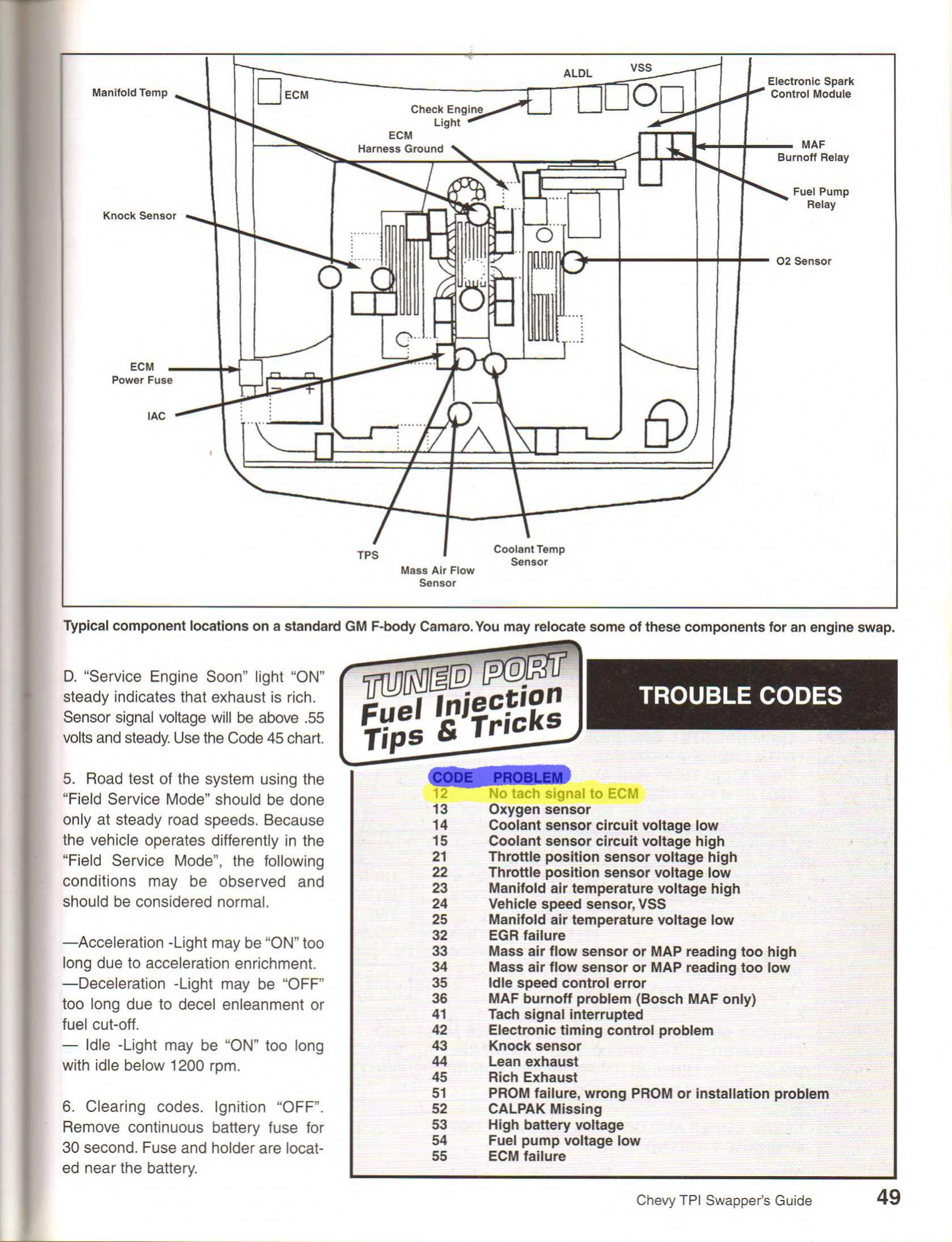

Are you sure its not a code? If it aint, then why do these two reputable sources classify them as codes?
Fuel naturally "sloshes" around when you brake or accelerate.
Instead of changing the MAF, I'd rather test it out before buying a Reman from Autozone which is a couple $100 or the Dealership which charges over $1,000.
Attached Thumbnails Shop cant figure this out...maybe some1 can help me?-troublecode.jpg   Shop cant figure this out...maybe some1 can help me?-tc12.jpg   Shop cant figure this out...maybe some1 can help me?-90.jpg
Well, technically 12 is a code, but none of us refer to it as a "trouble code".
12. No reference pulses to Electronic Control Module (ECM).
- means there are no electronic signals being sent to the ECM - why? Because you have shorted out the pins in the port to retreive ECM data. The ECM can't retreive data from sensors AND send stored data (to you) at the same time with this paperclip method. Thus EVERYTIME you short the data port pins you get this "code" letting you know that the ECM is not (or cannot) receive signals from the sensors.
Or at least that's how I always interpret it.

Yup. Well said. The code 12 was towards the member who stated that it wasn't a code. I replied in question form.

Sorry...its not a trouble code in this instance. Its basically telling you the computer is going to give you any codes that it has stored. It goes back to 12, or repeats 12 if there are no codes. He listed 12 as if he thought it was a "trouble code"...which it is not. There might be a way of reading the ECM with a snap on type tool that if it showed a 12 would be a problem. I.E. not using the paper clip method.

12 isnt a code. 12 is telling you that the ECM is in diagnostic mode and its going to spit out codes. It should go back to 12s after the codes are done.
34 I BELIEVE is related to either the MAP sensor or MAF sensor.

So code 12 isnt a code? Here is the definition of a code:
attach a code to; "Code the pieces with numbers so that you can identify them later"
In communications, a code is a rule for converting a piece of info (for example, a letter, word, phrase, or gesture) into another form or representation (one sign into another sign), not necessarily of the same type.

Since TC 34 came up in this thread, I might aswell post up on the TC troubleshooting method.
Pg. 90 is in a earlier post above.
Attached Thumbnails Shop cant figure this out...maybe some1 can help me?-89.jpg   Shop cant figure this out...maybe some1 can help me?-91.jpg   Shop cant figure this out...maybe some1 can help me?-92.jpg

ok guys enough debate about the code 12....it is a code but not a trouble code...there debate settled.... i was pretty sure that it wasnt relevant but i just wanted to make sure...since i started this thread i did look into it and found out that it just means that its going into diagnostic mode
