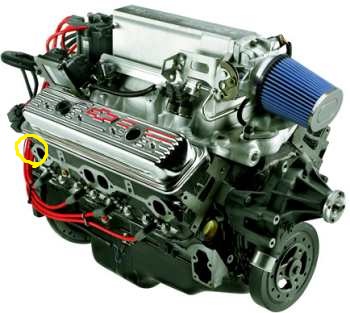

the studs in the block the exhaust manifolds mount to. so far only the furthest back passenger side is broken flush with the block. the rest are still attached with bolts holding the manifolds on. With the a/c system removed you can get your whole arm down there to drill it.
the volvo redblock's stud is broken off flush with the block on the farthest right side if looking from passenger side tire. Again, just removing the MAF, and hose to the turbo and radiator hose, its easy to access.
See attached pictures for reference (not my engines, look for yellow circles)
