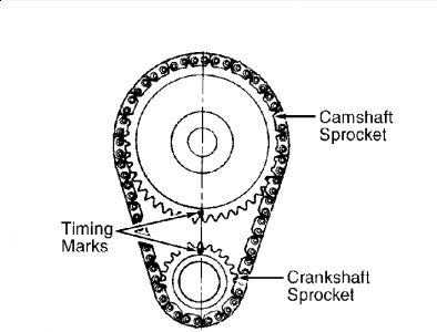

its been awhile since i had it apart, but i remember putting the dots basically touching, i couldn't have put the sprockets on incorrectly could i? if so what is the correct way of installing them?

Re: no start
also, just to be clear, you did read that i was rotating the engine backwards, and not base the valve timing being off just off of the first post?
will be working on it in the morning
If you were this close, you did it right.
