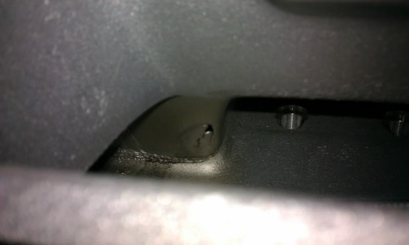

Yah take your time and break that in right Just before this swap here I had lingenfelter 219 cam with a Ported super ram that went 11.5@121MPH. Now we raised the compression to 11-1 Had Archie change out the springs and added all the trick light weight keepers and added a AFR rev kit and stud girdles and the ls7 lifters, Bigger injectors and Loosed up my convertor from a 3k to a 4k PI 5 Disc Lock up with the updated kevlar clutches. You want to see the sad part of this whole swap?
Hole in my brand new Miniram.
I had to wait 6 weeks for a new one.

I saw video of the Mini ram hole. Didn't notice the hole as well in the video though. That stinks but TPIS seems to be a solid company though and I'm sure they took good care of you. The 150 shot should put you at a solid 670HP. Breaking into the 10s should be very doable. Did Archie squirm over 11:1 compression on pump gas? I remember him telling me he didn't like going over 9.5:1 on street motors. Or do you run 110 race gas. I've been thinking of going with thinner head gaskets to move closer to 10.6:1. I think I could get away with it on the Twisted Wedge heads.
