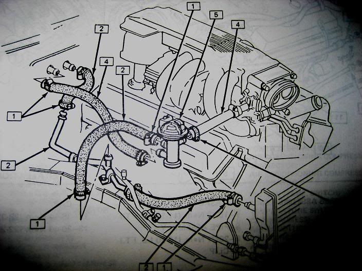

do you know what this is
a metal tube that runs along the frame on the passenger side in the engine compartment. hooks up to the firewall. i think it is for the heater. i don't know what it is called to replace it as mine is rotted out. it is #2. and i don't have tpi, just carb so do i really need it or just run rubber hose.

That is a heater pipe. You can replace it with rubber. Though finding the OE part will help preserve the integrity of the car. Just be sure if you use rubber hose, to route it away from the exhaust manifold.

Thats part of the whole system that bypasses the heater core when the AC is on so it blows colder. Number 5 breaks a lot apparently. If you switched to carb you'd usually just run one hose from your heater core to the top of the water pump, and one hose from the heater core to the intake manifold, and cap off the connection on the radiator. My car's too old to have that setup so I dont know if the diverter valve even works without the computer stuff set up.

so it will blow colder if i have something that stops the flow like #5.
