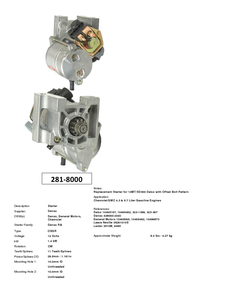

Time to look at starters and decided to go for a servicable gear reduction- ordered this LT4 style starter so haven't installed yet. Not impressed with overseas quality, but due to northern climate (-40C) needed something HD with less draw than the directdrive style- but had to have the staggered bolt mount 168 tooth. Look at Denso reman 281-8000 (1996 Suburban 5.7L) you'll likely need 10mm bolts- (2004 8.1L)
