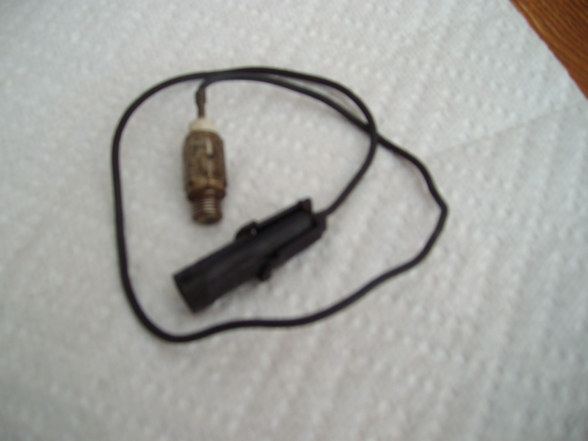

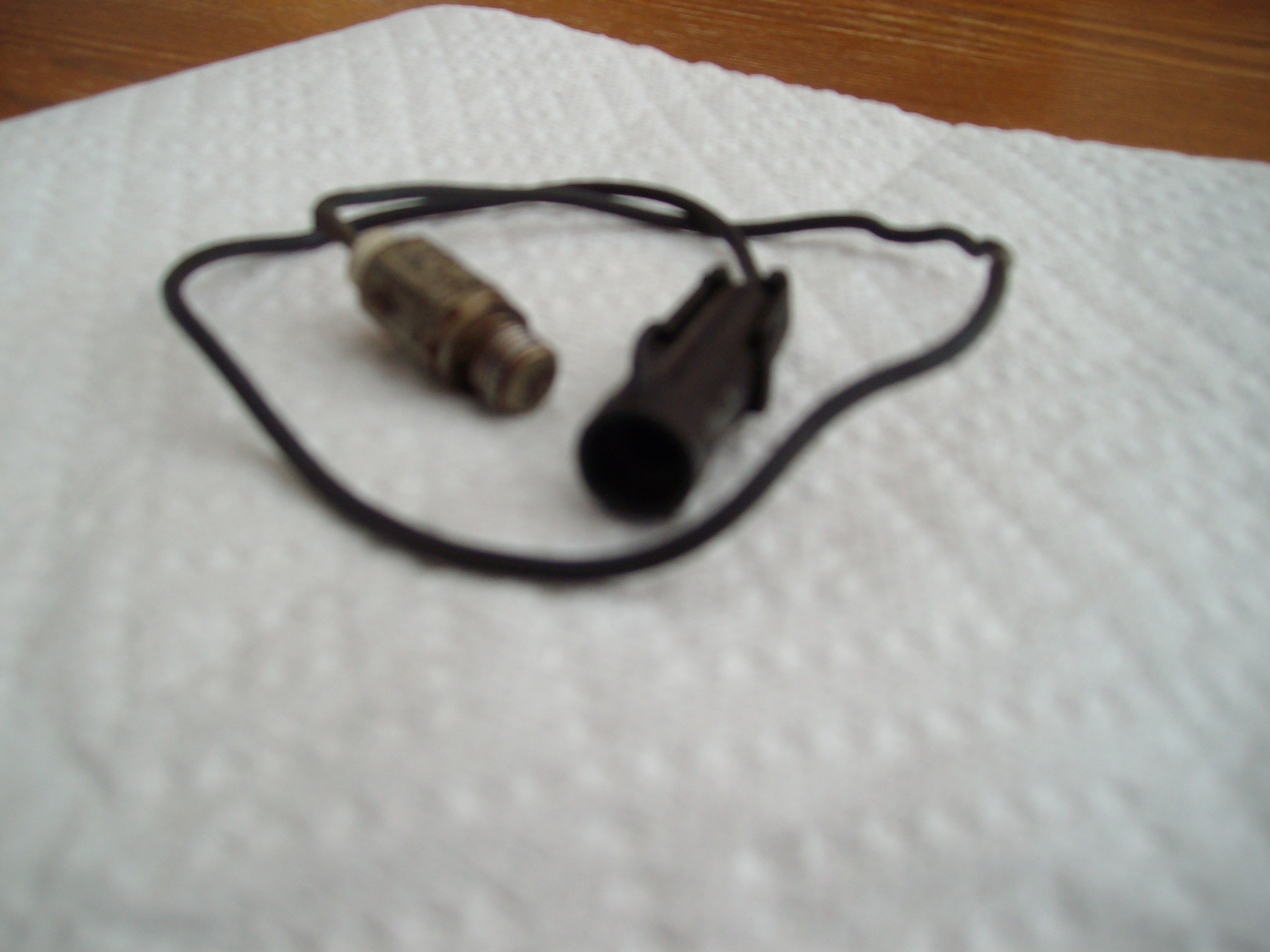

Originally Posted by Deven534
Need an egr temperature sensor for my 1987 pontiac trans am with a 350 tpi V8 in it...can anyone help me out?
PM me, i have a good used one I'll work out with you, Cheap.

Old Mar 14, 2011 | 03:10 PM
camaronewbie's Avatar
Joined: Sep 2002
Posts: 9,192
Likes: 19
From: Cary, North Carolina
Car: 1992 RS
Engine: Carbed 350
Axle/Gears: 3.42 posi
Re: Egr Temperature Sensor
Oh wow - never knew that. Sorry I was wrong!

IIRC, the MAF cars had a temp sensor and the SD cars don't. So might be why camaronewbie thought there wasn't a temp sensor. I don't ever recall seeing anything on my car that looks remotely close to what is pictured above. Please correct me if I am wrong.
Old Mar 15, 2011 | 02:25 AM
vetteoz's Avatar
iTrader: (13)
Joined: Apr 2005
Posts: 7,736
Likes: 14
From: Not in Kansas anymore
Car: 82 Z28
Engine: 383 SP EFI/ 4150 TB
Transmission: T400
Axle/Gears: QP 9" 3.73
The SD cars register the change in manifold vac through the MAP sensor to determine if EGR gases are flowing when commanded
