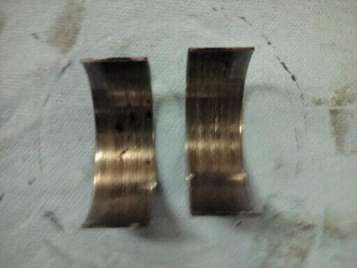

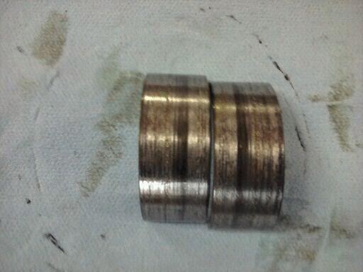

#2 rod bearing:
Old May 9, 2011 | 01:48 PM
Posts: 27,918
Likes: 2,448
Re: junk?
That looks like the bearing seized to the crank and spun in the rod bore... although the phots are kind of blurry.
Is that what happened? Is the rod damaged?
At least it wasn't anything related to a H/C/I swap.

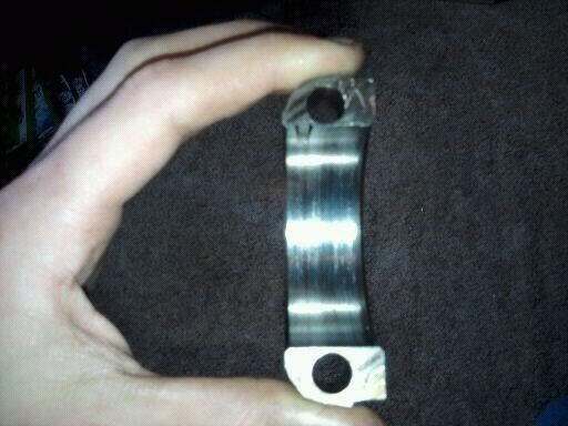

Heres a picture of the cap it looks kinda bad but you can barley feel anything.
Old May 9, 2011 | 06:58 PM
Posts: 27,918
Likes: 2,448
Re: junk?
Looks damaged. Doesn't look runnable to me. I'd have to measure it to be sure though.

Re: junk?
YOu have 2 short blocks, right?
What does the other short block you have look like?

Re: junk?
yea i do have anothers one that the thrust bearing is out on ill just put the crank kit in that one if theres no easy way to fix this one.

Re: junk?
Yeah this one, that rod & piston is going to have to come out; which means new rings on at least that one cyl; which once you're at that point, might as well do em all.
Besides the thrust bearing issue, what kind of shape is that other one in? What took out the thrust bearing?

Re: junk?
i do not know what took it out the motor was givin to me its a target motor with supposedly only 30k on it but i suspect it has more. The crank just slides back and forth is the onlything wrong with it. It ran fine when i have it in there and then realized that.
