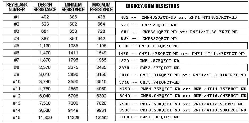

http://www.austinthirdgen.org/index.php?pid=41
The chart pic should be revised with is chart soon to include Digikey.com resistors. Not the only place to buy them, but is a good source instead of searching.
