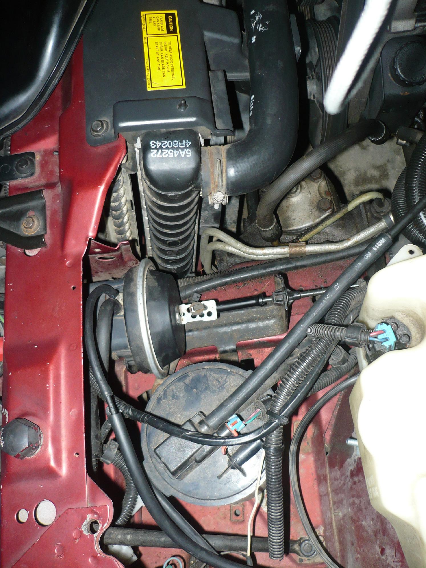

Can you post a picture of what your cruise unit looks like? Is it mounted up near the radiator near the charcole canister?

Yes that is exactly where it is located

Mine will surge as well and the unit is brand new. It looks almost identical to yours. The only thing I can figure is that there is a small leak in the system somewhere which causes the unit to search for the right speed (mine locks the carb throttle linkage based on engine vacuum so far as I can tell) to keep. I would assume yours is the same issue.
So far as the vacuum dropping away...check the vacuum coming out of the intake, the brake booster is a good reference or another one low on the intake or throttle body/plenum if you can find it. If everything is blocked off properly or doesn't leak, the vacuum should increase as the RPM's increase.
I've never personally checked how the vacuum reacts coming off the ball itself.
