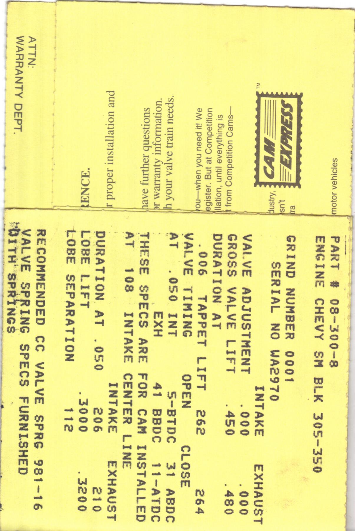

I installed this cam as per factory instructions. Was that my best course of action? My timing is also at the factory setting
