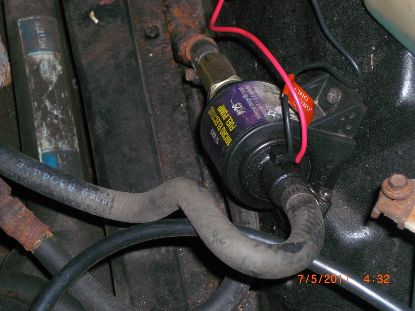

ok i heard of using the wiring but this is what i got going on two pumps intank and this other cheap
Attached Thumbnails fuel and carb problems-cimg5261.jpg   fuel and carb problems-cimg5262.jpg

Re: fuel and carb problems
Originally Posted by affliction1
you dont have to remove the old in tank,just un hook it and use the wiring harness for it to run inline eletric,saves time and effort
Except your inline pump won't get great flow sucking through the dead pump in the tank.
I agree. Mallory 4309 with return style should work if the intank is still good. If it was a fuel injection pump prior it's getting way to much pressure to be bottle necked by the non-return style regulator. In that case it's pushing 40+ psi into a regulator that's trying to stop it at 6.0 to 8.5 psi. That'll build up heat in the pump and kill the pump. It also can/will overpower the regulator and force more to the carb causing leaks and other issues.
You shouldn't try to pull fuel through a dead pump. It'll just make the new pump work harder and kill it. Also when fuel pumps die they sometimes tend to send debris through the lines.

so i should take off the pump that is in the front leave the intank and add then just add the regulator, im like 99% sure the intank is still working thats why it flooded the carb i shoul put the regulator before the carb, like in figure 3b right...well like the 2nd sample down
Yes, put regulator under the hood. The larger 3/8th line is the feed, runs to any side port on the 4309. Smaller 5/16 line is return, connects to bottom of the 4309. Then another 3/8th line from any other side port on 4309 to your carb (with another small filter inline). You can get metric-to-NPT adapters at any local hardwarte store in the brass plumbing section, as well as the 5/16 and 3/8 hose barbs.
