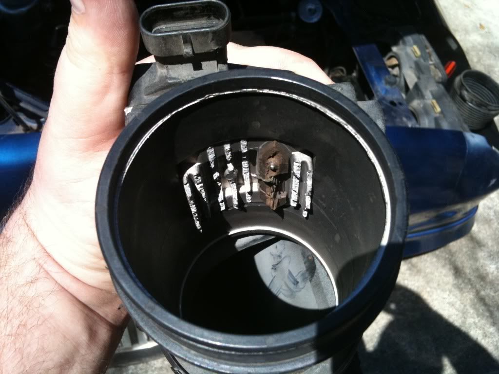

http://i1225.photobucket.com/albums/...stZ/Camaro.jpg
I can't figure out how to attach a photo but this link should show the mangled MAF.

Okay, yeah that's not functional at all. It seems that its only there for tubing purposes, not for the ECM to read air mixture. What ECM is in your car? Are you 100% sure its a stock tune?

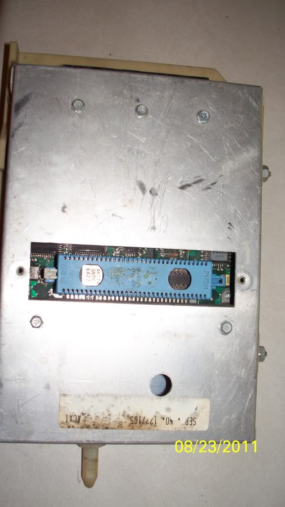

What I found on the computer was "1227165 ACXT". I found a UPS slip that said contents of package was a chip. That's pretty much all I know. <-- And it was from Lingenfelter.

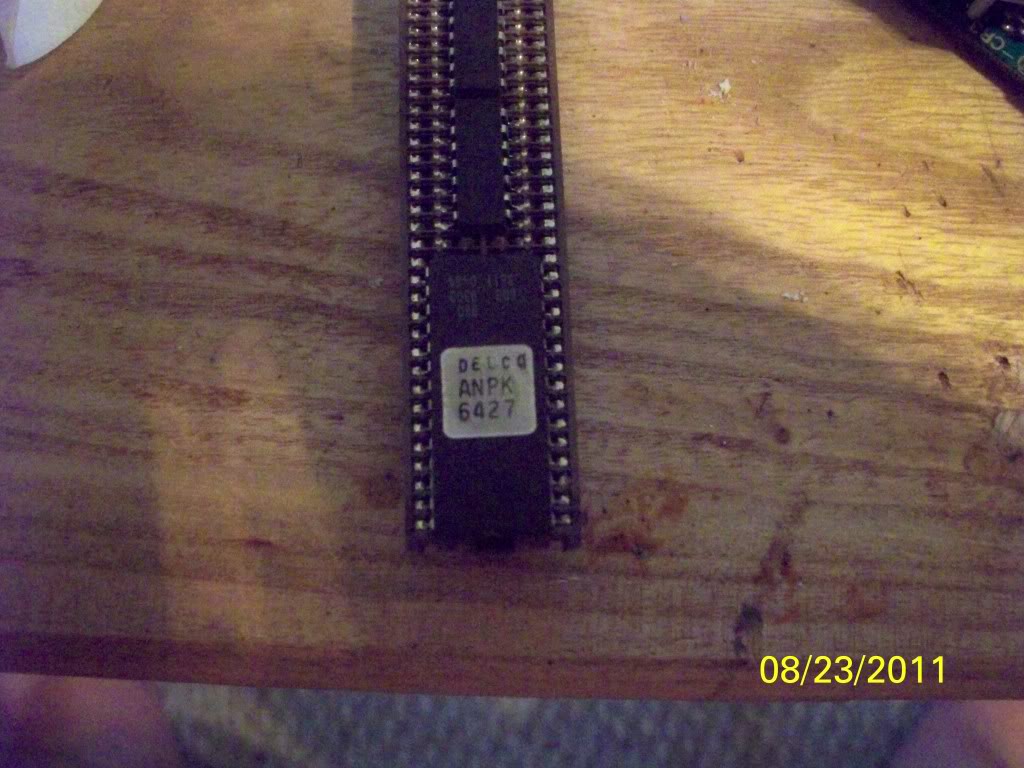

I just found a picture of an untouched computer and mine is missing the cover over the PROM. So it has definitly been messed with.

Yep, it's been custom tuned to not read the MAF. The hand held Scantron OBDI programers can clear codes, they have those at Autozone for $40-$60. But, I think the codes just pop on again once you turn the car back on.

http://photobucket.com/3rdCoastZ
You would think as much as I paid for this camera it would take better pictures.
I hear about people tuning out their MAF. Is this different from speed density?

yowza! I didnt think you ment that the maf was raped!!! lol
post a pic of the mafs if you can!!
I have no clue y someone would tune the maf out.. well I do but..

Honestly, that's a stock chip with the stock code for a 1988 Camaro. Did you see my earlier post about a scan tool from Autozone?
Might be the best way to go seeing that the gutted MAF is working....

Originally Posted by heat seeker
Honestly, that's a stock prom with the stock code for a Camaro. Did you see my earlier post about a scan tool from Autozone?
Do you think the check engine light will stay off long enough for inspection?
How would I know if it was converted to speed density and if it was why does it run like crap when I plug in an unmolested MAF?
I will check out the scan tool also, won't hurt to have one anyway.

I really don't get why someone would do this.

Holy hell!!!!!
Just 4 inspection can you remove the bulb? or do they need 2 see it working??

Originally Posted by TTOP350
Holy hell!!!!!
lol, it's brutal.
One of my buddies told me to just unplug it but I would think they would still know from plugging into the computer for the inspection. Or I could just wait until next year and it will be a classic. Then I only have to pass safety inspection and not enviromental.

Looks like the MAF monster went right thur that poor thing!!
I believe that the code will come back on once the car is re-started.
I really don't think it's been converted to speed density. The ECM looks exactly like mine. I think the MAF was just tuned out.
I thought so too, but if it was it shouldn't be throwing a code. right?

Time for a data scan with the engine running. The backup resistor chips should not allow it to run that well, but an improper tune with a MAF could be worse, thus the noticeable improvement with essentially no MAF installed. A custom PROM is likely in your future, and S/D is probably the way to go with that many cubes.

If the MAF had its wires removed and everything, then theyre running it an an alpha-n system using just the TPS. If thats the case, youll need to retune the ECM to work properly. With the MAF unplugged, its impossible to say what the engine is actually getting fuel and spark wise.
