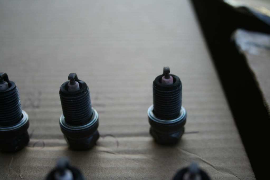

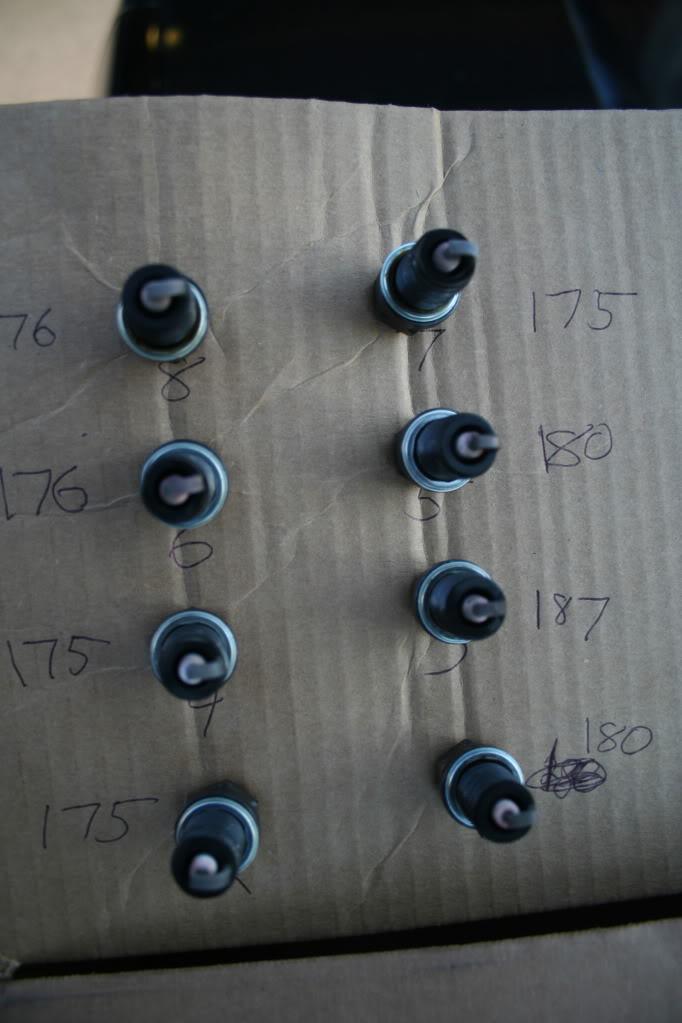

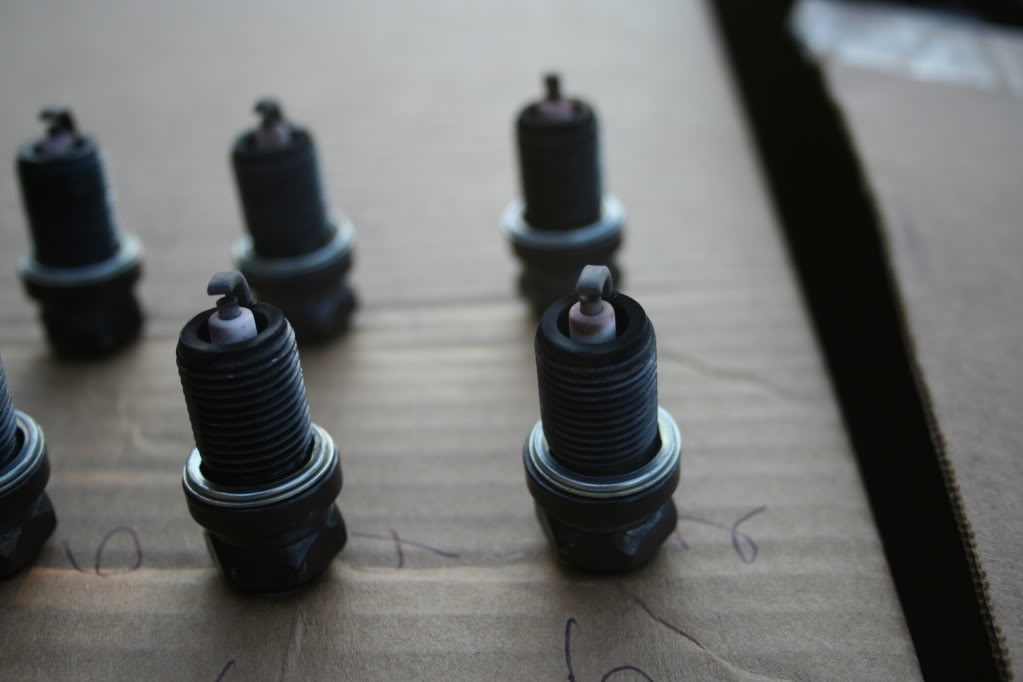

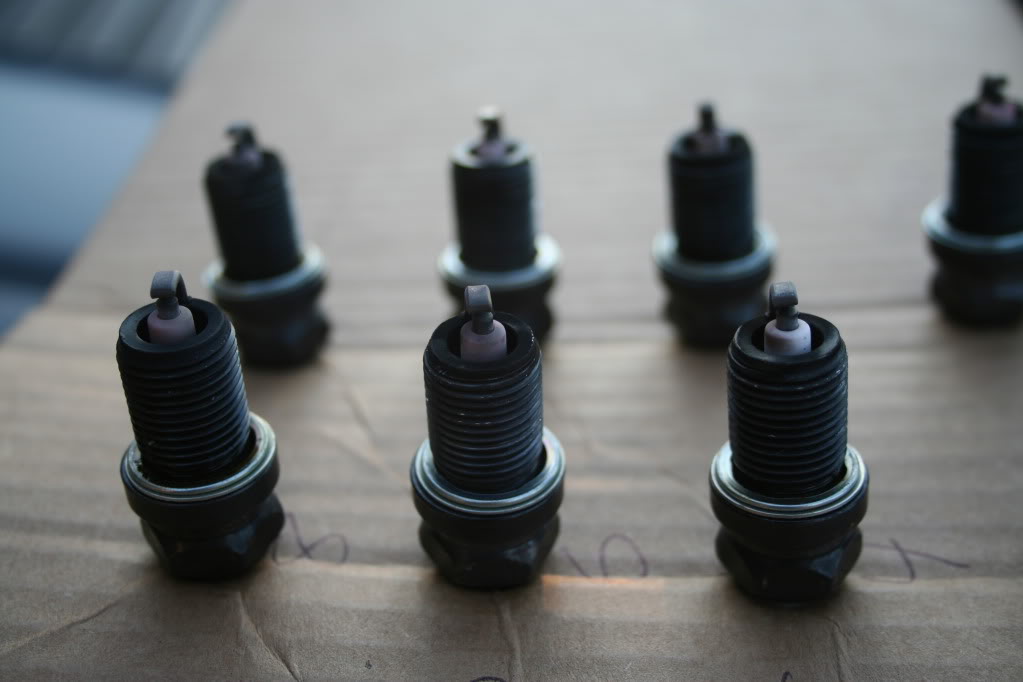

can you post CLEAR LABELED pictures of the spark plugs?

You might have some bad injectors. Read the plugs to see if any are showing signs of going lean.

Old Sep 8, 2011 | 07:13 PM
gixxer9's Avatar
Joined: Aug 2003
Posts: 278
From: Madison, WI
Car: 86 IROC
Engine: 6.2
Axle/Gears: 10 Bolt 4.10
Re: Underperforming 383
Old Sep 8, 2011 | 07:20 PM
gixxer9's Avatar
Joined: Aug 2003
Posts: 278
From: Madison, WI
Car: 86 IROC
Engine: 6.2
Old Sep 8, 2011 | 08:05 PM

The photos didn't come out as well as I expected.. All of the plug insulators are rose colored.
I tested the cylinder pressures in this order: 1, 3, 5, 7, 8, 6, 4, 2, 1
The compression (engine cold, throttle closed) is as follows:
Cylinder:
1. 200, 180 (first cylinder tested was at 200, I checked it again after the other 7 cylinders and it was 180)
2. 175
3. 187
4. 175
5. 180
6. 176
7. 175
8. 176
