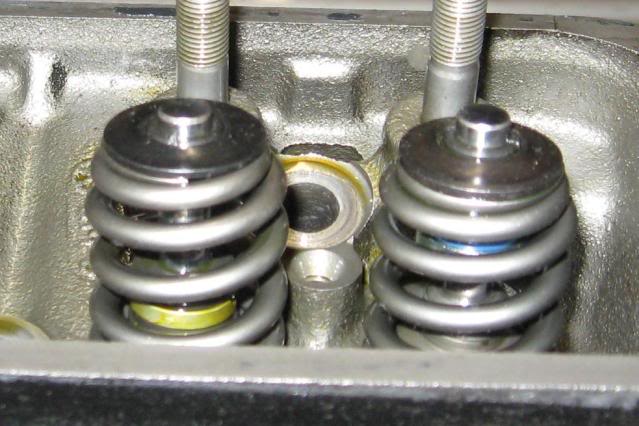

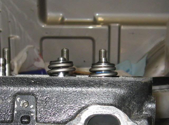

Originally Posted by fiveoformula
Very interesting article, so to me it sounds like I could safely use a cam that has .550" lift without modifying the guide at all? correct me if im wrong...
I am still sort of confused how the beehive spring will give me more retainer to guide clearance, I understand that you would have more room before coil bind.
The kit has different retainers as well

Interesting, are those steel retainers? Would titanium retainers generally give you even more room?
I have no idea the best bet would be to call comp cams and see what they have for you.
