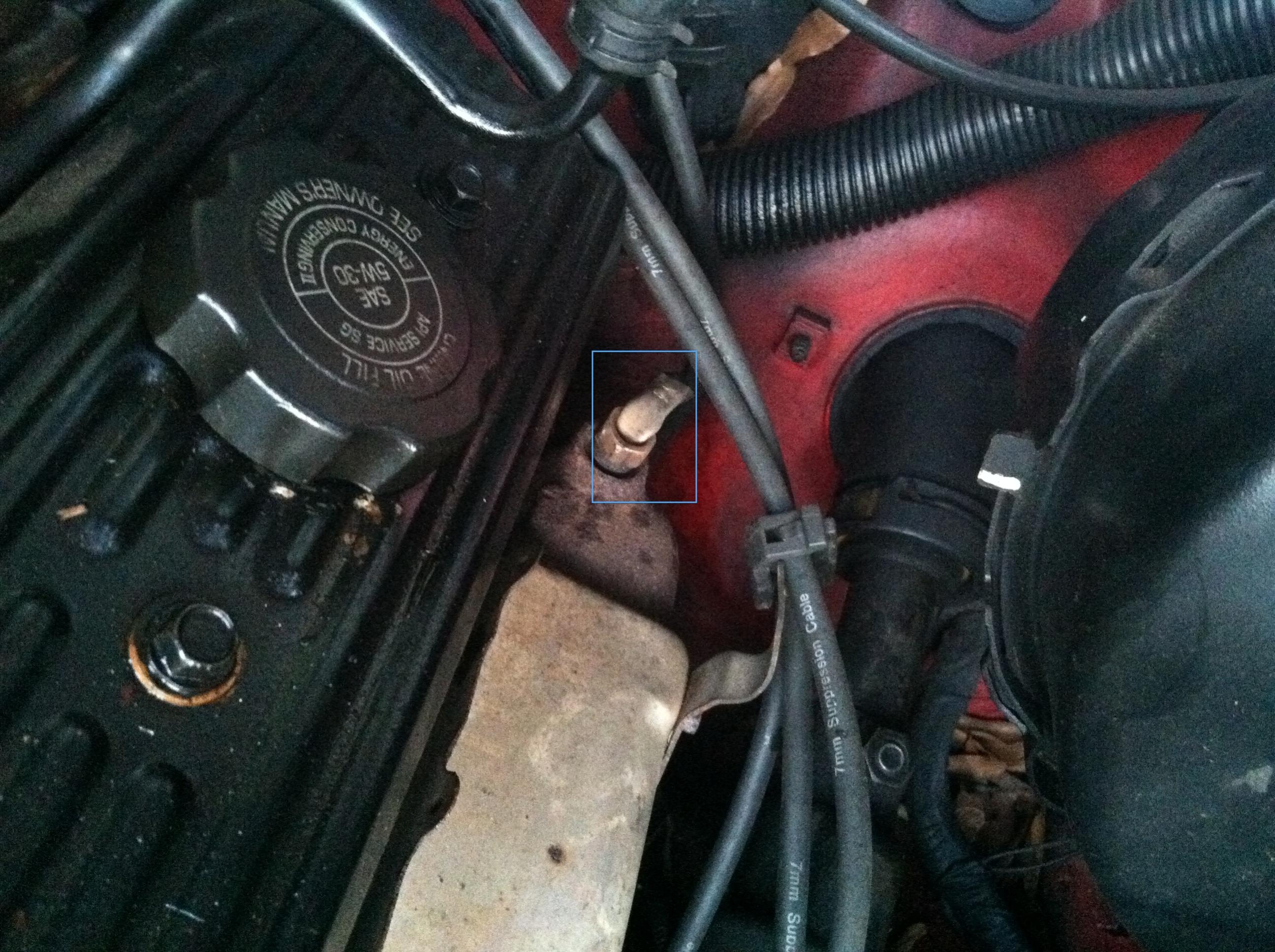

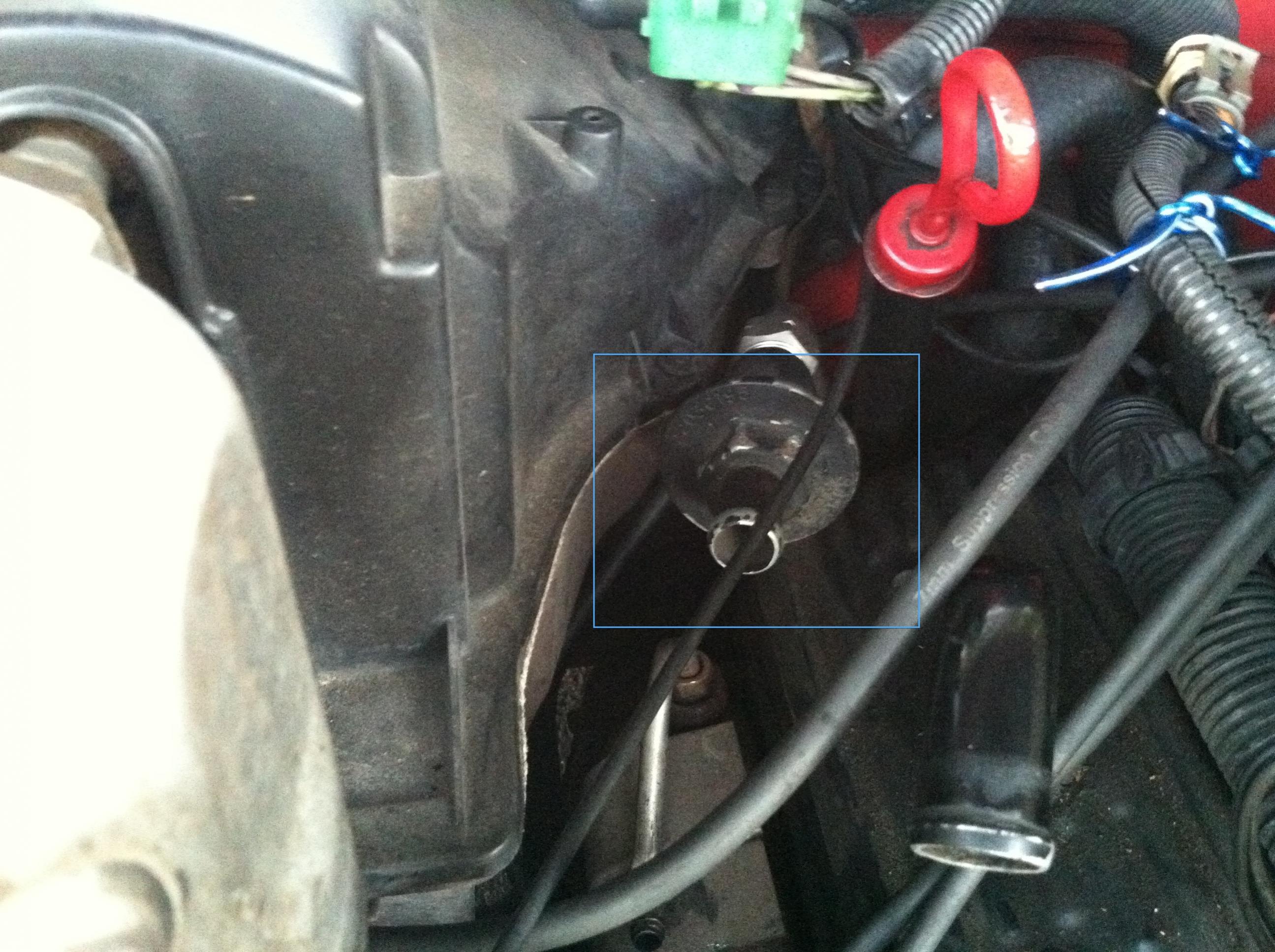

Here are some pictures of what I am dealing with. One of the pictures is the back of the air pump. You cant really see very well but there is a place for a pipe. There is a picture of the extra sensor connectors that melted. If anyone can give me some insight on what is suppose to be hooked up to the stuff i took pictures of i would appreciate it. Have a feeling it is all emissions and EGR stuff.
Attached Thumbnails Need Help.  So many Problems.-img_0058.jpg   Need Help.  So many Problems.-img_0059.jpg

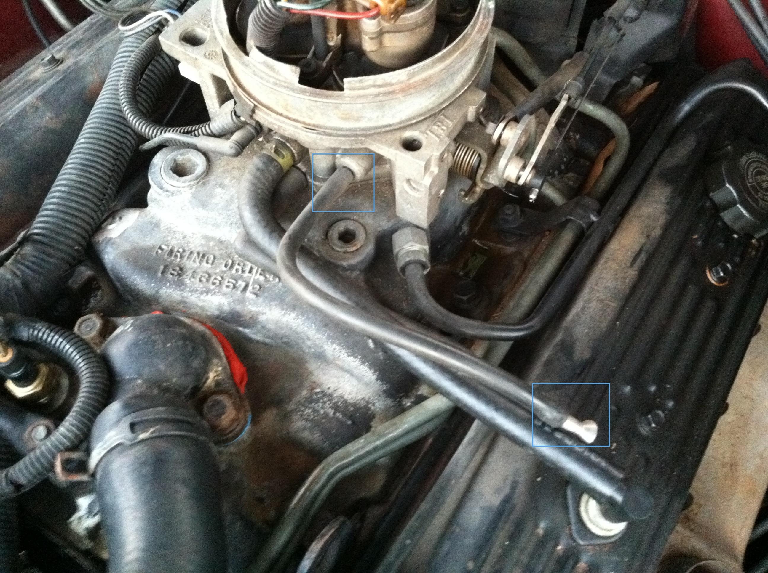

More Pictures
Attached Thumbnails Need Help.  So many Problems.-img_0060.jpg   Need Help.  So many Problems.-img_0061.jpg   Need Help.  So many Problems.-img_0062.jpg

Re: Need Help. So many Problems.
And more
Attached Thumbnails Need Help.  So many Problems.-img_0063.jpg   Need Help.  So many Problems.-img_0064.jpg   Need Help.  So many Problems.-img_0065.jpg

Your EGR seems to be still there, but the AIR (smog pump, etc) system seems to be removed or capped off. I'm guessing there is no longer a catalytic converter at the other end of that pipe either. Plugged port on front of the TBI is for the charcoal canister and fuel vapor purge system which I'm also guessing is gone. Hope you don't need to pass any smog testing there. Burnt plug is for the Air valve also gone. Last pic shows the vacuum source for heater bypass and HVAC controls, etc

I found a post on how to clean up my engine bay. Gave me an idea on how to repeat what the po did to my car. Only thing i need to know is what would i need to hook back up to fix my idle and excess smoke in my exhaust. The po tried to do the smog pump delete and failed badly. think i still have the charcoal canister. It is near the wiper reservoir correct?
