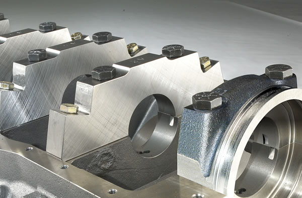

It's just an extra bolt on the main caps. the 3 middle caps have an extra outer bolt. Not as strong as an aftermarket splayed 4-bolt, prone to cracks. If you're making enough power that 2-bolt blocks are a problem you need splayed four-bolts IMO.
But as iwth most of these things, people get all hung up on these old school ways of thinking and 4-bolt was one of those big buzz words.
2-bolt
Factory 4-bolt
Splayed 4-bolt - made from a 2-bolt block
Best thing to do with a 4-bolt non-roller block is to hock it some old school dude for money and get a roller block with the proceeds.
