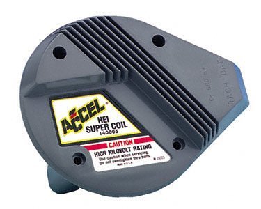

Would you say that this HEI coil is the same as the Accel HEI Super coil?

I've been using Accel HEI for 12 years. Only changed twice for tune ups.
1st was in my '75 Camaro Bigblock for 8 years, now in the '87 small block.
Good weather drivers only.
No complaints from me with Accel.
That does look like the Accel.
