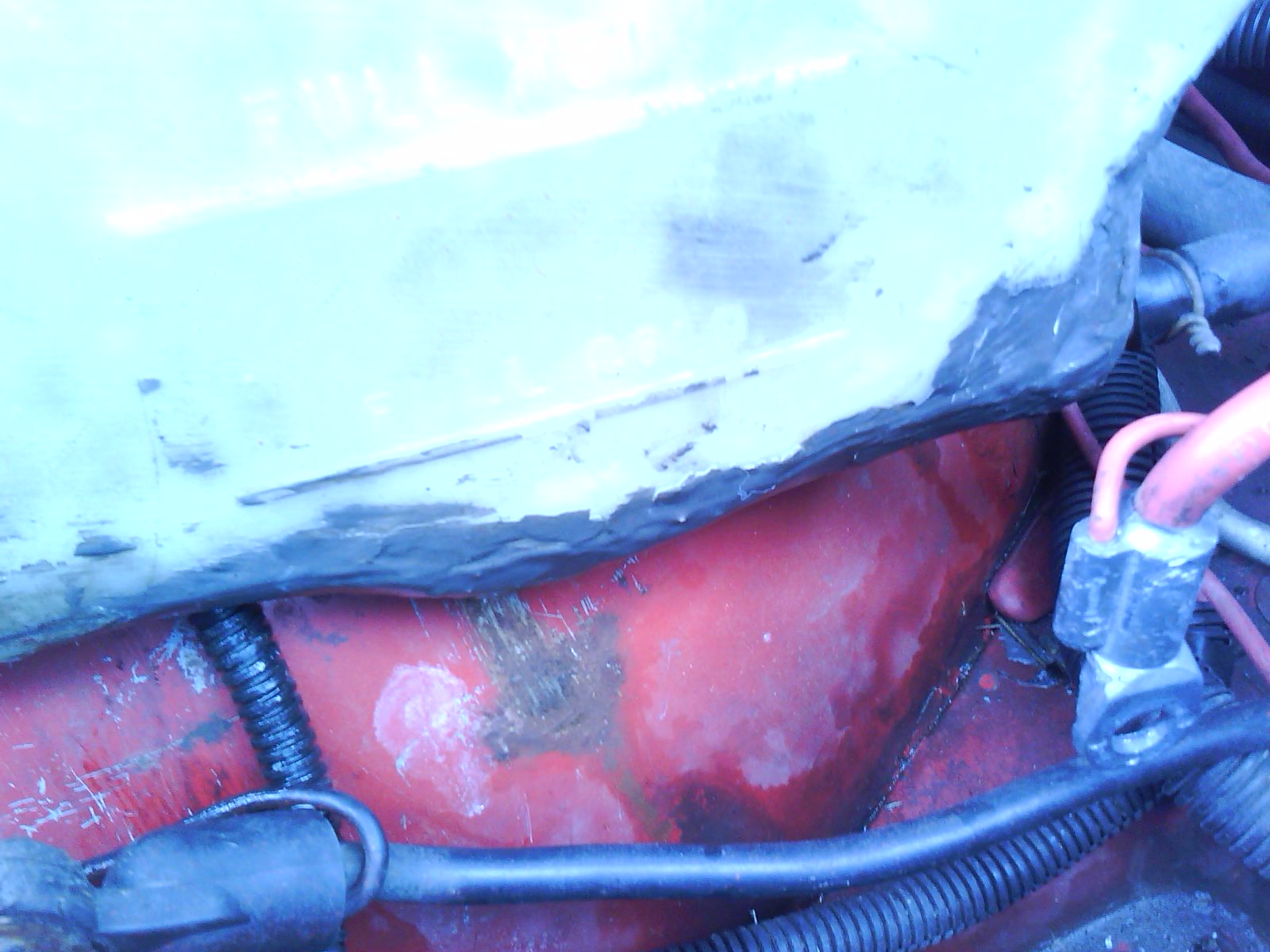

When I took out the battery this is what I found on the coolent container
