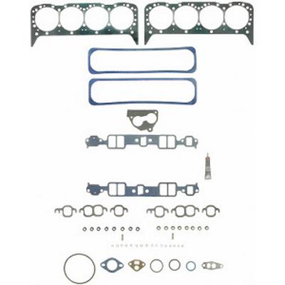

When you put the heads back on, you probably noticed a port in the center of each, that has exhaust in it.
THINK about that concept for a minute. The guys that are talking about "blowby" are sort of close to the right track, although not quite. THINK about those exhaust ports in the heads, and what would happen if the intake gasket was bad right there.
OK, now that you've THOUGHT about it for a little bit, what would happen?
Exhaust gas would force itself into the crankcase and create pressure which would then blow oil out every possible hole, eh?
Pop your intake back off, and you'll find the gasket is damaged on at least one side, across the bottom, at the center.
Put all the "doom & gloom" scenarios of needing a new motor, "compression tests", messing with the PCV valve, and "maybe it's this maybe it's that" OUT OF YOUR MIND, and instead, THINK. It's absolutely amazing how powerful the human mind can be when allowed to do its job. Then proceed to THE ONLY logical explanation for the symptoms you are observing, and LEAVE ALL THE REST OF THAT STUFF ALONE.

No, it was from the Felpro head gasket set and it looks like the picture below.
The only sealant I used on the intake manifolds was on the edges that faced the China wall (valley) because the manual called for running sealant in the valley and up towards the intake manifold gaskets.
