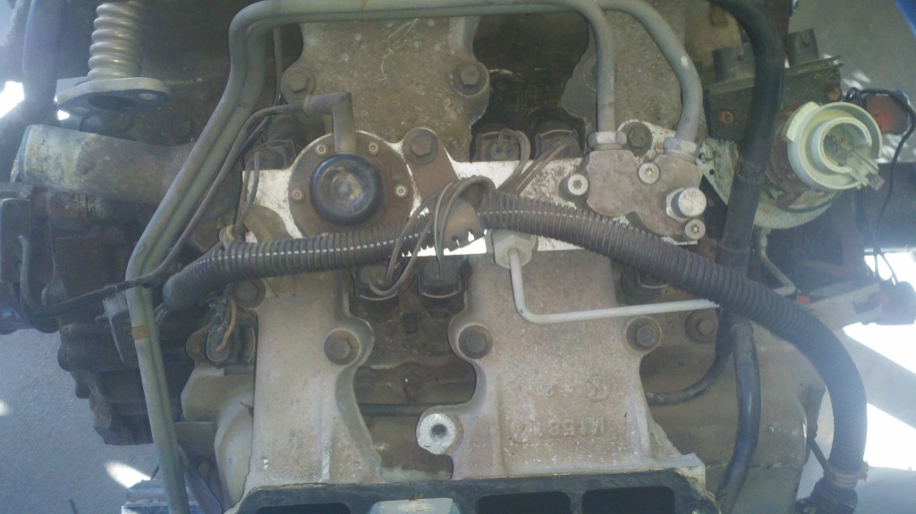

The 2.8 intake is a "sandwich" affair. Uppper, middle and lower. Gaskets between each of them. I believe you will only need to remove the upper and middle layers of the "sandwich" to replace the FP regulator. Might even be able to do it without touching the intake at all, but I'll defer to those with more experience on that engine to chime in about the actual R&R procedure.

Looks like the top has to come off, might change the middle gasket & injector O rings while your at it.
Attached Thumbnails Any1 Have Same Engine who can help-2012-01-04_15-15
