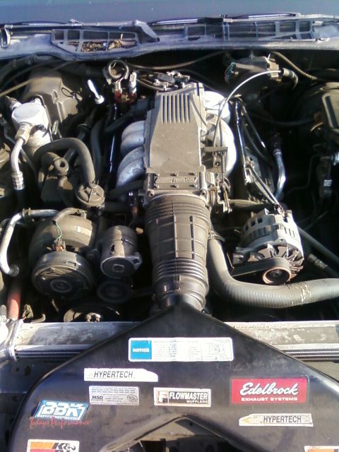

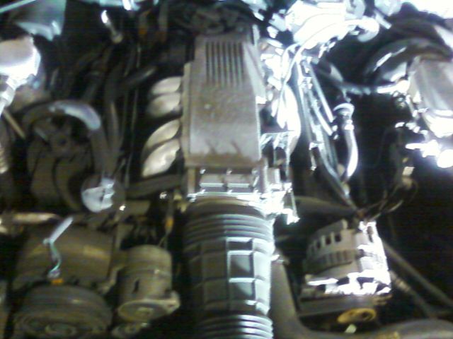

Here is the picture of my engine and the TPS.
A mechanic told me the problem is the TPS, but my TPS is modified, so he does not know where to get another one.
Any suggestions?

Old Jan 31, 2012 | 06:23 PM
Tuned Performance's Avatar
Community Influencer
iTrader: (95)
Posts: 16,901
Likes: 1,014
From: Mile High Country !!!
Car: 1967 Camaro, 91 z28
Engine: Lb9
Transmission: M20
Re: TPS problem fo 91 Z28?
That is a 90-92 tpi map setup, you have a l98 not a lt1 !!

Old Jan 31, 2012 | 06:45 PM
ChevyJ's Avatar
Joined: Jan 2012
Posts: 7
Thank you for the clarification. Again, I am ignorant and I appreciate your input. The ebay TPS and the one I have looks different. Did you see second pix i posted? it is a bit blurry but it appears different. Thank you.

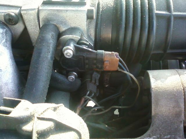

Attachment 233453Attachment 233453You know what, I think it is the same or at least similar.
I got confused with the orange connector and the wiring.
I was told my a mechanic that it was specially modified. Was he wrong? Is that just a normal TPS and connector/wiring?
So I also attached a better pix of the inside.
So, you are saying it's not a LT1.
My car is a 91 chevy z28, so what kind of engine is that again?
And I also found this: http://www.autozone.com/autozone/par...questid=108748
Will that work as well? Thank you.

Old Feb 1, 2012 | 04:25 PM
iTrader: (95)
Posts: 16,901
Likes: 1,014
Engine: Lb9
Transmission: M20
you would need to check the numbers on the block behind the drivers head or the 8th digit of your vin number 8 l98 5.7l tpi, F lb9 5.0L tpi This is a tuned port injection engine.
Old Feb 1, 2012 | 04:28 PM
iTrader: (95)
Posts: 16,901
Likes: 1,014
Engine: Lb9
Transmission: M20
That tps you listed for autozone is correct. I just don't like to take risks on electrical parts is why I suggested a known oe quality part. Guys here have gone the cheap route only to replace it weeks later.

Old Feb 3, 2012 | 11:22 AM
iTrader: (95)
Posts: 16,901
Likes: 1,014
Engine: Lb9
Transmission: M20
you can do it your self there is no adjustment needed. disconnect you battery while you are doing it to clear any codes. looks like you might want to replace the tps weather pack connector looks kinda hammered and moister could have caused the failure in the first place.
