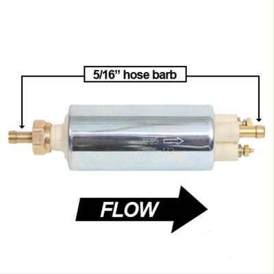

Okay I changed the fuel pump and that still didn't fix my problem
Having no car sucks too...
Anyhow I still do not hear the fuel pump when I turn the key.
So...
-Can't be relay . I tried changing this before the fuel pump
-Put in a new fuel pump and still nothing
what could it be? please help

I dropped the tank. It was a real PITA. And I found out my fuel pump isn't even inside the tank. It was mounted behind it so I ended up having to order an aftermarket fuel pump external.
Sorry I'm kind of a noob and I just went straight for the part replacement...now I'm starting to think that the fuel pump may not have even been the problem and it could be something electrical.
I'll take it as a learning experience though- I know how to change out a fuel pump and I have a backup fuel pump now if it never went out to begin with.
Is this scenario possible?
When my car broke down the alternator went out and then my battery didn't have enough juice to crank it back up and prime the relay?

Picture of my fuel pump
Wanna add that my fuel pump is hanging vertical behind the tank. Where the wires are is the bottom and the outlet is on the top.

and before I drop my tank and junk again....I'm gonna try flipping the fuel pump and see if its not backwards or something. Though my old fuel pump had the wires at the bottom this is a vastly different pump.
edit: actually just realized I think I have her in backwards. Vertical fuel pumps are suppose to be installed with the outlet up and if I'm not mistaken the outlet is where the wires are....and I have it at the bottom right now.

Always is a good feeling. I think I just had some flawed logic...
because see heres my old fuel pump
so I installed my new fuel pump with the wires at the bottom.... thinking that it was the inlet as well.
edit: now I know for sure I have it on backwards
this pump looks close to mine and the outlet is where the wires are at
doh hope this solves my problem. boy I miss driving my iroc.

and ultimately I think it is because my fuel pump is installed upside down (which I can confirm now) . However before I proceed I think I'm just gonna hook my fuel pump on the battery and see if I can feel suction coming from the inlet and pressure coming from the outlet just to be sure...

Some more updates
-the leak is actually not coming from a fuel line. Its coming from my pump! the seals are defective....fml ordering a new one
-only good news is my alternator might not be bad at all. I could just have the wires at the top switched by accident.
seems I have a history of doing things backwards.
