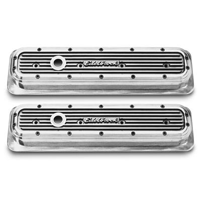

Edelbrock Valve Covers Elite Series # 4246 http://static.summitracing.com/globa...e/EDL-4246.jpg

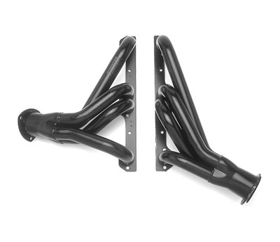

Short Hedman Headers # 68470 http://static.summitracing.com/globa.../HED-68470.jpg
Hedman Y-Pipe # 17478 http://static.summitracing.com/globa...ed-17478_w.jpg
Fine. Hopefully won't be as prone to leakage as the factory stamped steel covers.

Ended up returning these (They arn't emissions legal):
So I ordered this set up:
Hedman Headers + Y-Pipe # 68481 http://www.jegs.com/images/photos/500/500/500-68481.jpg (purchased at summitracing.com jegs just has a better pic...)
I wasn't aware headman made emissions legal headers. The only ones I'm aware of are Dougs, Hooker and Edelbrock.

Yeah, there is even a ceramic coated version but I can't remember the part number. They work really well though, and aside from the fact that it was a "difficult" project, we didn't have any unexpected problems with the headers or hooking them up right.
