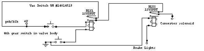

Torque converter clutch lock-up is controlled by a solenoid in the case of the transmission. Pressure to activate the TCC is supplied by the front pump (as are all auto tranny functions). However, the pressure is only supplied to the TCC when the tranny is in 2nd, 3rd, or 4th gears. The solenoid actually closes off the return for the TCC pressure passage, such that when the solenoid is activated, the return is shut off and pressure is applied to the clutch disk. When the solenoid is deactivated, the TCC fluid flow just returns to the pan.
12 volt positive power is always applied to the solenoid when the brake pedal is not depressed (applying the brake opens a switch and removes the power from the solenoid circuit). The circuit is completed by the ECM to energize the solenoid by grounding the electrical return. Some vehicles are programmed so that the ECM will not lock up the TCC unless the transmission is in 4th gear, sensed by a pressure switch in the 4th gear pressure passage in the valve body. My LG4, however, would lock up in 2nd or 3rd gear if conditions were correct (over 41 mph, manifold vacuum and throttle position within certain parameters, etc.).
The reason I told you all this is simple - you can get a pressure switch that is normally open, and grounds when pressure is applied. Reroute the ECM grounding wire for the TCC solenoid that is in the tranny pan to such a switch on the 4th gear pressure passage, and you'll have TCC lock-up whenever the transmission is in 4th gear and the brake isn't applied. When you hit the brake, the TCC will unlock.
But, since you're dumbing down your car and don't really care about fuel economy, why don't you just put a TH350 or TH400 in your car while you're at it? Then you won't have to worry about these things.
Of course, if you kept the computer controls and spent your time & money on what is really holding back performance on your car, you'd have a better car in the end. But, if you really want to go primitive, it's your car, your money, your funeral.
"Primitive" is why 14-sec "sports cars" used to get 10 mpg. "Electronic stuff" is why 12-sec daily drivers will get 25 mpg today.

So do i connect c451 to a toggle switch and then to a ground, and then connect c452 to a 12v power source?

The reason I told you all this is simple - you can get a pressure switch that is normally open, and grounds when pressure is applied. Reroute the ECM grounding wire for the TCC solenoid that is in the tranny pan to such a switch on the 4th gear pressure passage, and you'll have TCC lock-up whenever the transmission is in 4th gear and the brake isn't applied. When you hit the brake, the TCC will unlock.[/QUOTE]
Im still trying to wrap my head around this. Also could i not just use the break switch that was used for the system originaly from the factory? And what prongs do i connect to on the plug on the outside of the transmission case?
You should still have the harness and plug that went to the trans with the colors that match diagram above?
Just reconnect the pink to your existing brake switch and you have power at trans.
Ground the tan / blk control wire through a switch to operate TCC

And all i would have to do is flip the switch when i go into overdrive

If you do very little mileage in OD, then tcc lockup makes no difference, as it only operates in OD anyway generally in thirdgen applications.
I drove my carb conversion with no tcc for years with no ill effects, but that was with virtually no highway driving. I hooked it up recently.
If you still have the factory wiring but with the computer removed - basically wire a toggle or better still vacuum switch between the tan/blk and light blue wires of the diagram a few posts up - or as per my first attached diagram.

Here's a way to hook up the TCC using a vacuum switch, a few relays and tying into existing circuits. The part is 14014519 GM which is a vacuum switch that senses low load. It's supposedly discontinued but look around and you can probably find an alternative somewhere like digikey or build a comparator circuit that uses the MAP Sensor load. Post recycled from another forum I put this on:
How the circuit works is as follows:The pink/black wire is energized when the key is in the "run" position. The vacuum switch turns on when the vehicle is pulling significant vacuum at low RPM. The fourth gear switch is connected to a chassis ground in the case. When the switch closes, this allows the relay RLY1 to energize and the converter clutch solenoid. The relay RLY2 serves the function of disconnecting the converter clutch solenoid when the brake pedal is pressed as actuation of the brakes when the converter is engaged is hard on the clutch in the converter.

The issue with lockup burning the boxes up was supposedly only on the early transmissions.
My early 700r4 was wired differently. It locked in 2nd and 3rd off the vacuum switch that was connected to ported vacuum through a TVS that blocked vacuum under 110°F. 4th gear locked off the 4th gear switch. The 4th gear switch was also wired through the EGR bleed solenoid which bled off the signal to the EGR valve. Q-Jet version of lean cruise.
Interesting. I didn't know they had a temperature component. That diagram isn't based off an OE configuration, it's based off just the raw logical steps I determined would enable a 700R4 to lock and do so safely.
