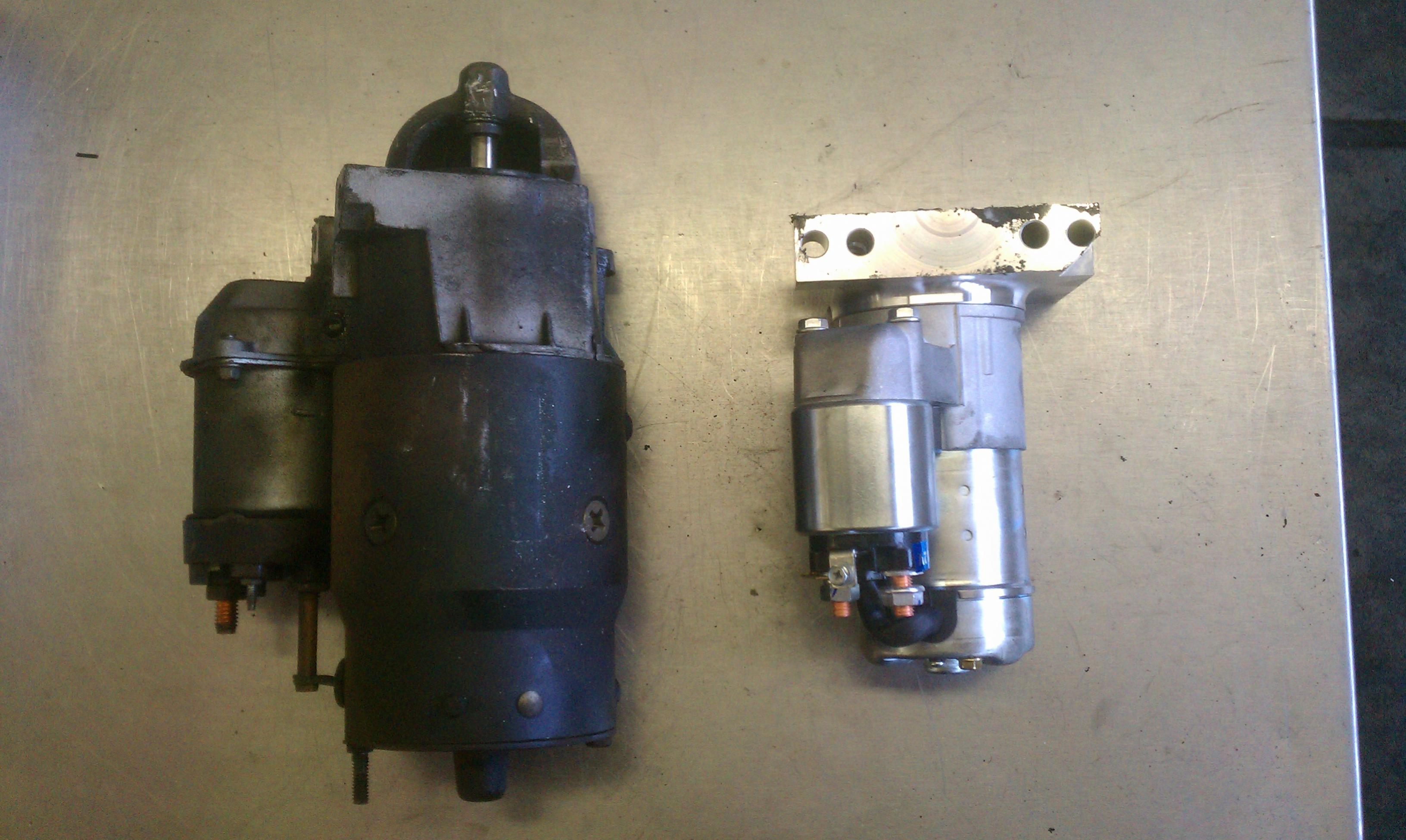

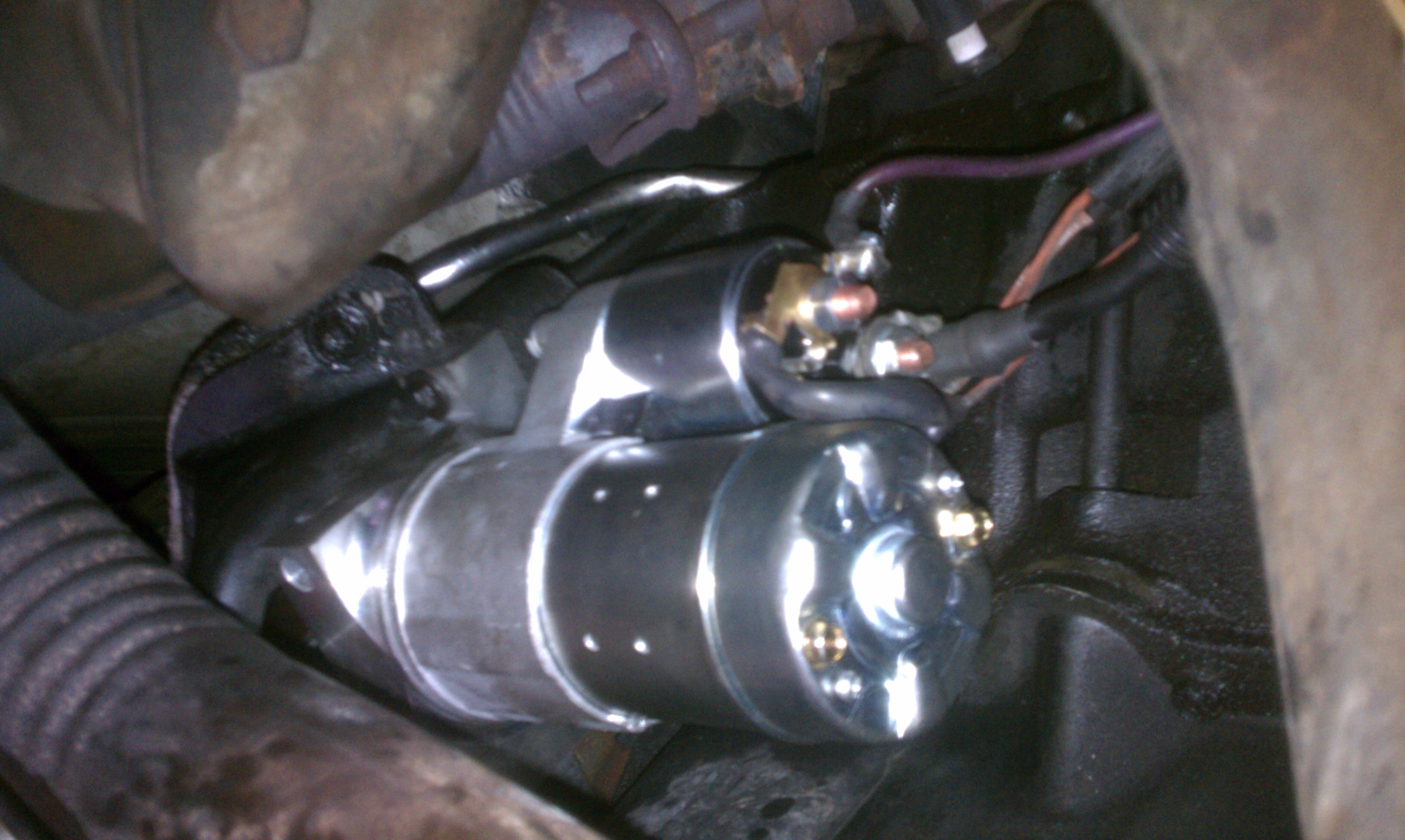

My OEM stock starter was dying so I just replaced it with a Summit Racing Mini High-Torque Starter SUM-829100 that cost me around $100 bucks http://www.summitracing.com/parts/SUM-829100 . I didn't need to shim it or anything. Removed that MAMMOTH STARTER that came with the Firebird and stuck this powerful little guy in there. Easy. The car fires right up every time

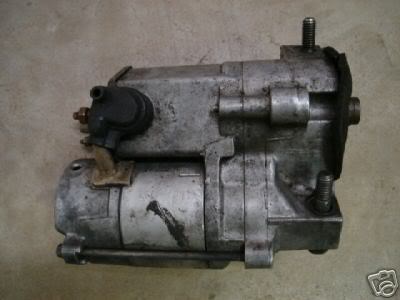

I don't think a 93-up LT1 camaro uses a starter like the 88-96 corvette does. The f-body might be a mini-starter by size but the corvette uses a gear reduction starter. Put a vette starter on and you will not have a problem again with heat soak. I have a 90 vette and it will crank over in any condition even 110 degree days when the a/c has been on.

That Vette starter in the photo is a Denso design gear reduction starter. It is a better, more rugged, design that the typical planetary type gear reduction starters. The only weakness they have is the contacts in the solenoid which are replaceable.

ASE doc - Now I'm a little worried. I didn't re-map anything, am I going to blow up my solenoid?

I'm sorry for causing you worry. No you won't blow anything up. Just avoid long cranking. Even when I didn't have my crank fuel tuned to start quickly on the first turn of the key, I used to just bump the starter for no more than a second at a time. Last year I guess I had a long senior moment and started just cranking the engine until it would start. It may have taken 3 or 4 seconds at times. The Powermaster starters, according to their tech line, are not designed for this and the contacts in the solenoid fuse together.
That's how I took out my solenid. Before that, I was running that starter for 7 years without a glitch. I like it because it cranks the engine at a higher speed which is good on my somewhat radical engine. However, with my cranking fuel dialed in, the engine starts up quickly now even with the OE gear reduction unit. If I do have an issue sometime, I just don't crank the starter for more than 2 seconds at a time. Of course if you run headers, you should invest in a starter wrap for added insurance.
