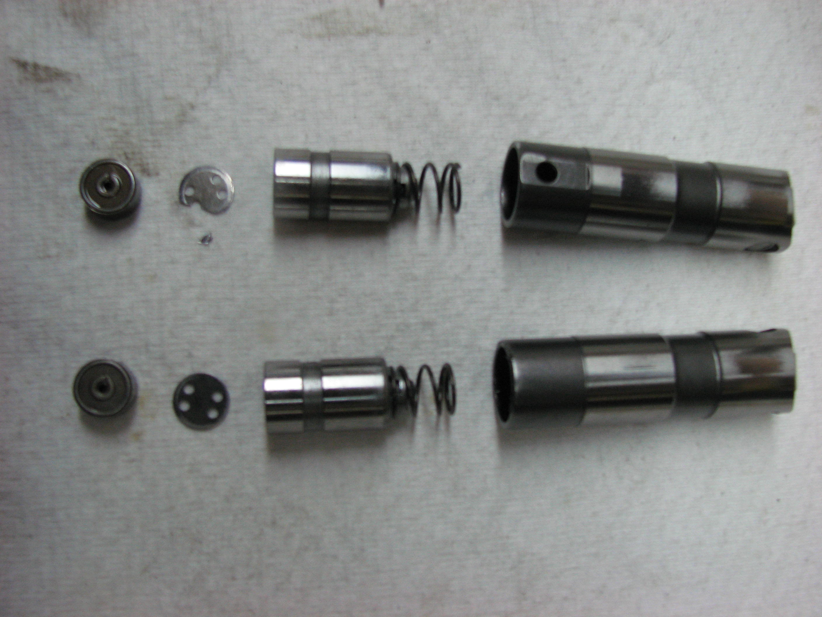

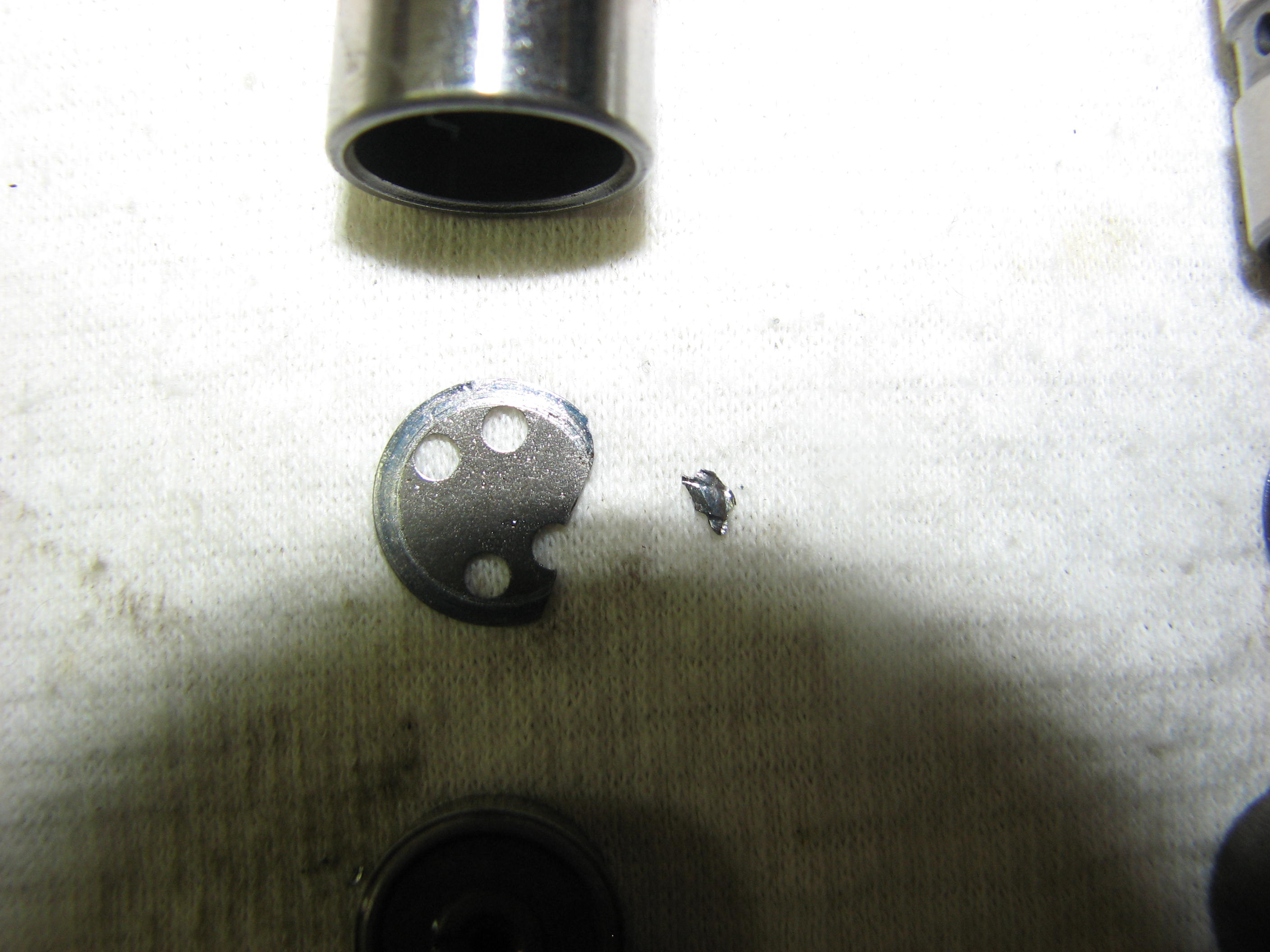

[QUOTE=Atilla the Fun;5290942]Did you disassemble the lifter in question? Was there any scoring? If so, did you get pics? If so, did you post them? Was it more difficult to disassemble than any other lifter? QUOTE]
The problem with these lifters is that the link bar is riveted to the lifter body. Disassembly means destruction.
I ground the rivets off two of the lifters that had collapsed.
It appears that the metering disc (for lack of a better phrase) has been broken. Comp isn't sure what has happened but they APPEAR willing to help me out in some way.
The lifters in picture have gone a lot of miles, some of them very difficult miles.
Attached Thumbnails Cam change. Engine in.-img_5762.jpg   Cam change. Engine in.-img_5765.jpg

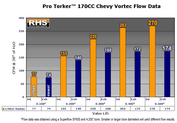

Good score on those heads, but I still wouldn't put them on any street 350. They need help in their exhaust ports, be sure the exhaust valves are undercut and get a back-cut. Be sure to fully polish those exhaust ports. Then I'd conversationally suggest you at least consider how they'd like a 10:1 383 with Comp's smallest HR Thumpr HR cam.
I thought they were a pretty good deal. I purchased them bare and then ordered the install kit. Ferrera valves (which I had back cut) included but the valve springs (Comp 987s)weren't to my liking especially considering the hydraulic roller. I opted for the Comp 26918 springs and associated hardware.
The valve job looks excellent with a radiused exhaust seat and 4 angle intake. All in all they appear to be good looking heads.
Yes, I've considered going to a 383. Thinking about it briefly (and conversationally) the small Thumper cam would build MOUNTAINS of torque.
I'm going to try that in my simulation program and see what the results are.
Attached Thumbnails Cam change. Engine in.-pro-torker-flow-chart.gif   Cam change. Engine in.-img_5661.jpg   Cam change. Engine in.-img_5662.jpg
Never seen exactly that before, but I can easily see that causing problems. If they'll just do a direct replacement, and them pay shipping, I'd be inclined to go for a test-drive. Your images of sim-dyno results didn't work for me. Guess I need to download some image conversion filter? Anyway... And liking that cam with those heads on a 383 came from this: (1) Study enough dyno results for 383s, you'll see they're best with about 20* overlap at 0.050", which the baby Thumpr has. Those heads are better above 0.475" intake lift than GM Vortecs, yet still need extra split in the cam. It's a perfect match. It isn't a cam you'd ever go Power-Touring with, or I'd say 9.5:1 What specs were you thinking for your next cam? If it's secret, please PM.
