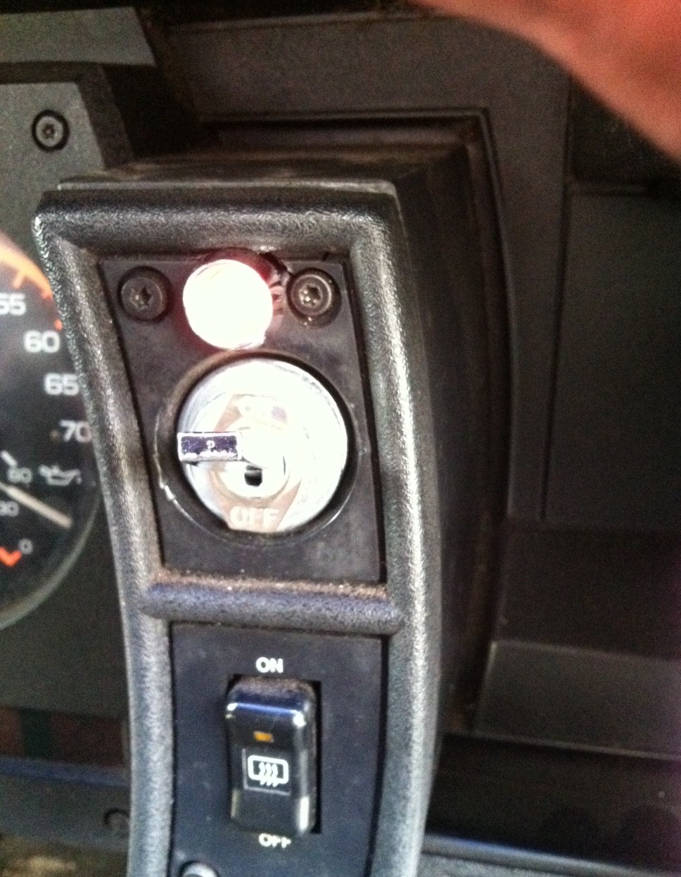

Just do what I did, Remove the cig lighter and buy a 50 amp toggle switch and a $10 12v red light at autoz0ne. Now run 12v power (10 or 12 gauge) to the switch then splice that into the fan power (fused of course). And for the light, just splice that in farther down where you added the additional power line(fuse it, i always fuse anything i wire in. Better safe than sorry). This will make it so you know when the fan is turned on by the computer and when you manually engage. To mount the light, just use the instructions to find out the drill hole size, and press it in. Doing this means the car will run on the stock settings and you can manually control it. All for about $15 ( Of course i had some wire and connectors) but yeah.
Funny note, when you turn off the fan, it takes a little bit for it to stop spinning, acting as a generator and you can see it pulse electricity back to the light.
Here's some pics:
Attached Thumbnails 180 Stat/Low Temp fan switch.-photo.jpg   180 Stat/Low Temp fan switch.-photo2.jpg

Either way is fine, I just prefer mine because I didn't know the wiring of the car, prefer to see when the fan is on, and can have a back-up in case the fuse, relay or stock wiring fails.
And this can apply to any electric fan vehicle.

Anyways on my car Im not a fan of toggle switches..to me they just look tacky on a factory dash.No offense to anyone who uses them.But since I no longer have a/c in my car and I wanted manual control of my secondary fan,I wired the old a/c signal wire with a relay to the secondary fan for complete factory switch using the hvac controls.Beauty of this is also that it only works with the key on instead of me using a toggle switch hooked up to a heavy gauge wire and running more wires into the car.
Just another way to make a cleaner option if you dont have a/c in your car still.
