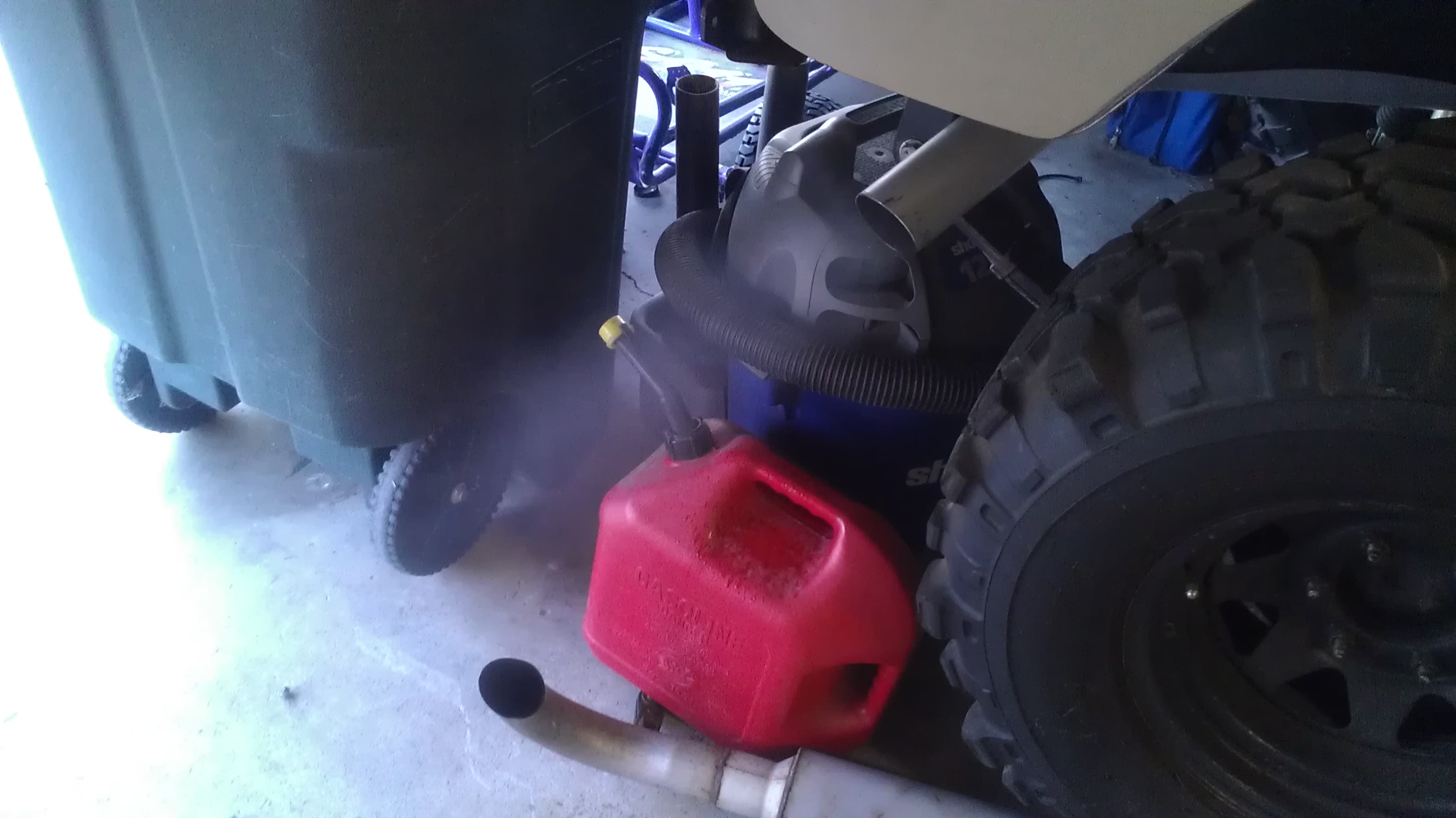

more logs, I put a vaccum gage inline with the MAP last night. 18" at idle, so I would assume no vaccum leaks.
Old Mar 20, 2013 | 03:04 PM
76 PTO's Avatar
Joined: Feb 2010
Posts: 31
Re: BURNING OIL WITH GOOD COMPRESSION
I'm a little concearned about the amount of water in the picture coming out of the tailpipe and hitting the fuel can.
