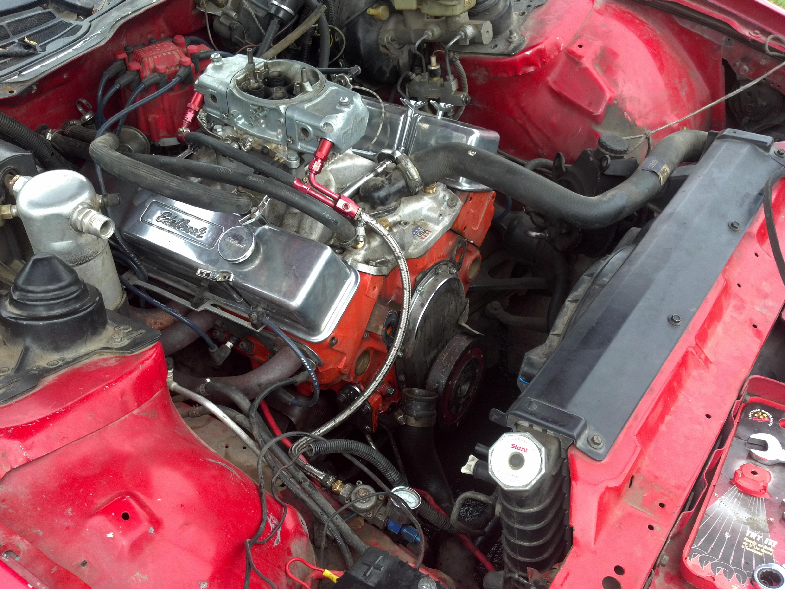

Couple pictures of the engine. The one of the engine in the car is before the victor jr. Im going to put that one back on the car this weekend to see if it cures my water in the oil problem
