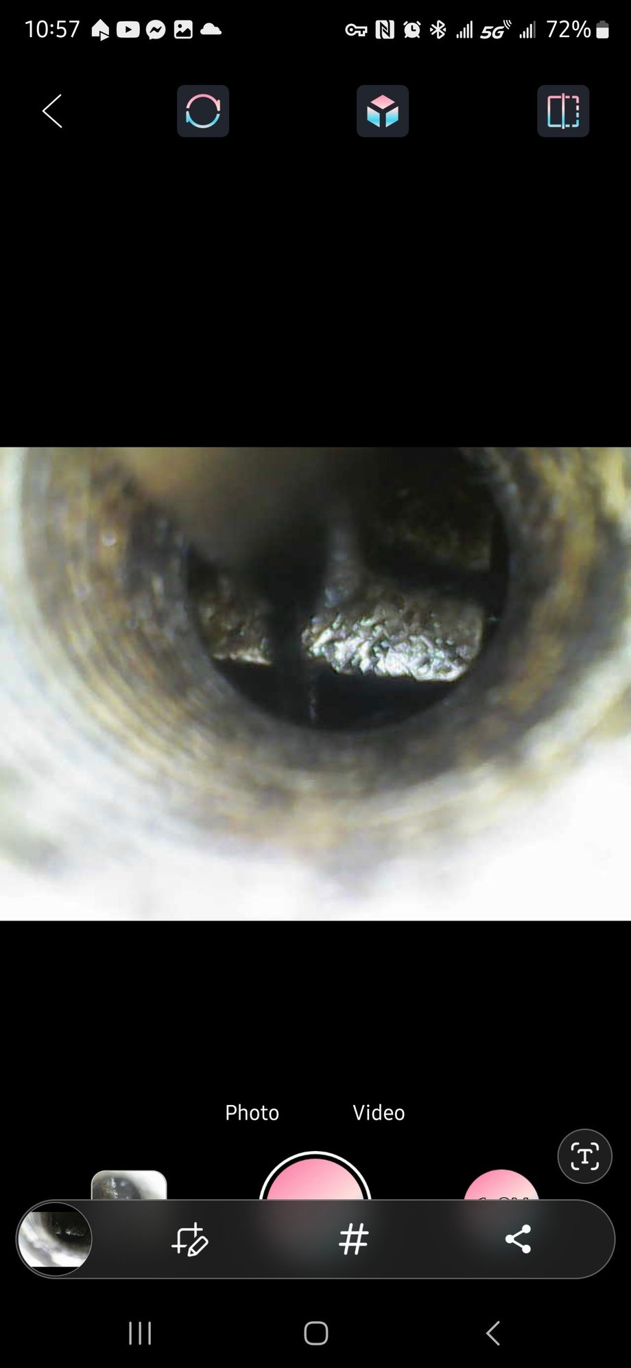

The piece that's in the on top of the piston, it's not magnatic an because the engine sits on a tilt it slide back aginst the cylinder wall.and it's too wide to come outside of the spark plug hole. I can't rotate the engine. The top bed center to pull the cylinder head off cus i cant get the timing marks to aligned. I tried vacuuming using the little claw device But it's just being difficult.
It's going to be difficult. Keep going at it with vacuum through spark plug hole, the internet cannot do this for you.

That kinda sorta looks like a valve spring retainer to me, but I have no good idea of how it could have found it's way into the cylinder
Unless, , , perhaps, the (two) retainers failed in holding the valve/spring assembly together, and that one retainer somehow miraculously fell down into the valve guide hole after the valve itself fell into the cylinder
I know, I know, , , we're talkin billion to one odds here, but that pic sure looks like a valve spring retainer, and a valve in the cylinder would be a great reason for not being able to turn the engine
Other than that, I got nothin............

It actually looks a little like a reverse image of a valve keeper, and that doesn't seem logical since a keeper would be a lot harder than the top of an aluminum piston, and also would be unlikely to embed in a cast iron head.
You might be onto something though.

It's a valve keeper. It's magnetic.
Still not understanding all this chatter and concern about "timing marks". THOSE DON'T MATTER. The piece isn't looking at them and deciding accordingly whether it will come out. Just bring that piston up to where it's reachable with a magnet that you can stick in through the spark plug hole.
Problem of course is, the block and head are magnetic too; which makes it tougher to control a magnet as you try to stick it into there. Maybe something else sticky; even chewing gum might do the trick.
Another strategy might be to pop the intake and that side valve cover off, compress the valve spring as far as possible to allow the valve to open, and vacuum it out through the intake port.
And FORGET ABOUT "rotate the engine", except as far as getting it up near the top.

Thanks for all the insight. This piece was wedged in between the valve of cylinder #1. I was able to knock it inside of the cylinder, thinking it would be easy to retrieve. I started to disassemble the engine. And came to realize that i can't rotate the engine.to get camshaft& crank to aline there timing marks an crankshaft TDC cus of this piece, preventing the piston from going all the way up fouri full engine rotation.

I don't think that it matters what kind of car it is. I agree that the guy has a keeper in the cylinder and to me, that is a problem that is year/make/model irrelevant.
I agree that it's ferrous and a magnet should grab it. I suspect that it's "stuffed" into the piston head and needs to be dislodged first, then caught w/a magnet. I'd fish it out w/the pisten at BDC, to give myself a better angle and range of motion with my magnet.

What I'm getting at is that doesn't look like a SBC piston and the sparkplug hole has threads on it a mile long and he tripping ***** about getting timing marks aligned on his engine. I don't know what a Pontiac "Iron Duke" 2.5L I4 engine piston or sparkplug hole threads look like nor do I know what they look like on a Chevy 2.8L/3.1L 60 degree V6 either. I do know that all of these engines are cam in block old school pushrod engines and it doesn't make a bit of difference where any of the timing marks are at to to pull the intake and heads.
I just want him and everyone trying to help him to be on the same page and know what they are dealing with.
I'd done have whatever it is in there sucked out by now using the set of attachments that came with my car detailing Shop-vac and a hose stuck on the end of one of the small round attachments and down the sparkplug hole.
