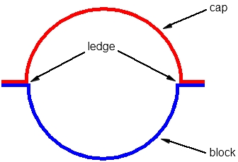

Anyway, I took the measurements very meticulously with the block on the floor: The front cap seems to have "tightened" up and is now quite nice to spec (though the front cap was pretty good before), but no significant differences on the 2, 3 and 4 caps than with the block on the stand - a few 10 thousandths here and there, but nothing that isn't accounted for by operator error or the precision of the measuring equipment.
If anyone is having trouble picturing what I'm describing, I've attached a drawing...
The #2, 3 and 4 caps are slightly wider than the block by several thousandths at the parting line... also they appear to be skewed to one side more than the other, so my "X" measurements at 60 degrees from vertical aren't the same on each side. The #4 cap isn't so bad, but #2 and #3 are.
Obviously, I'm asking around for advice on how to fix this... I've put a lot of time into this block for an incompetent machine shop (or bad caps) to send me back to the beginning again... and out at least hundreds of dollars.
