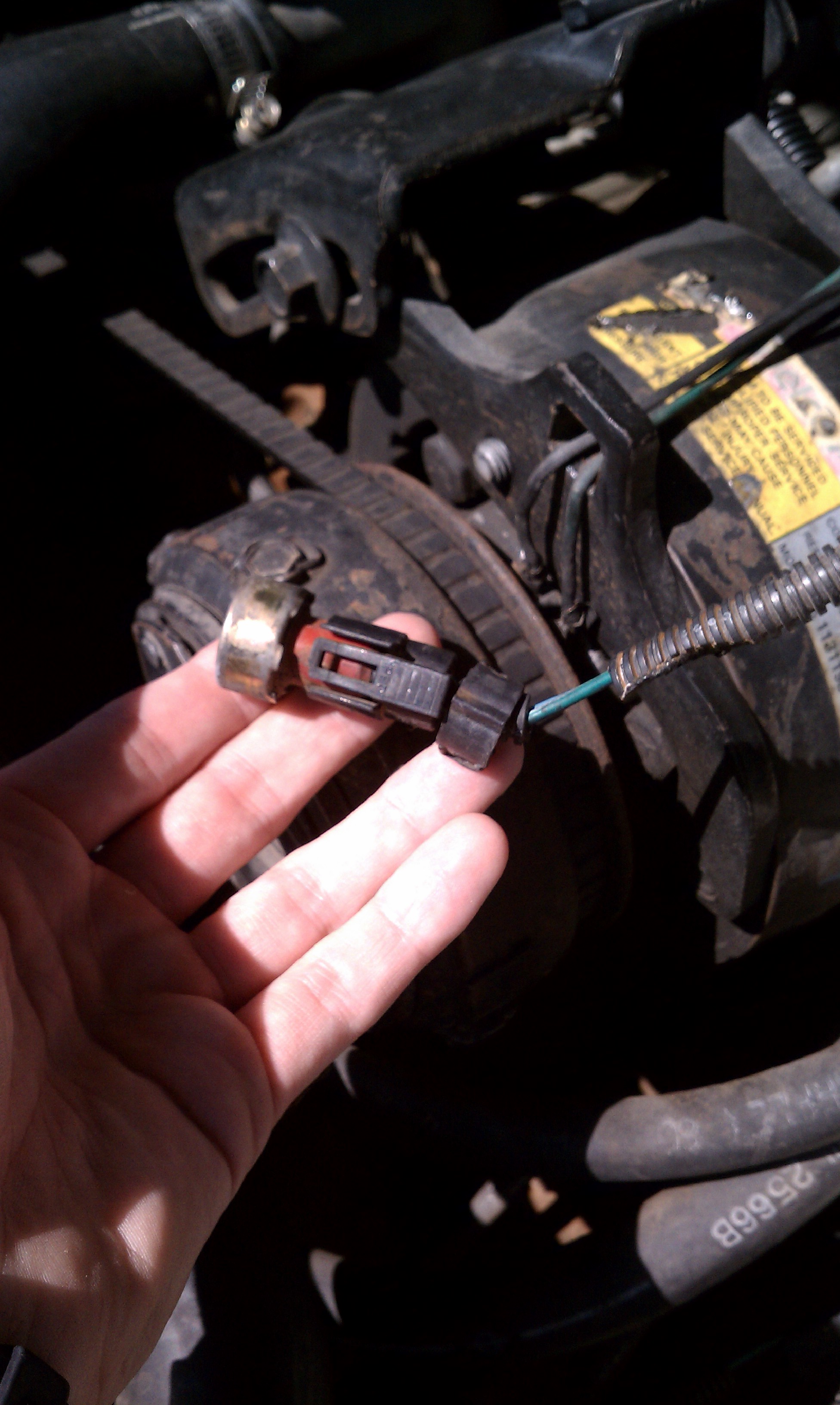

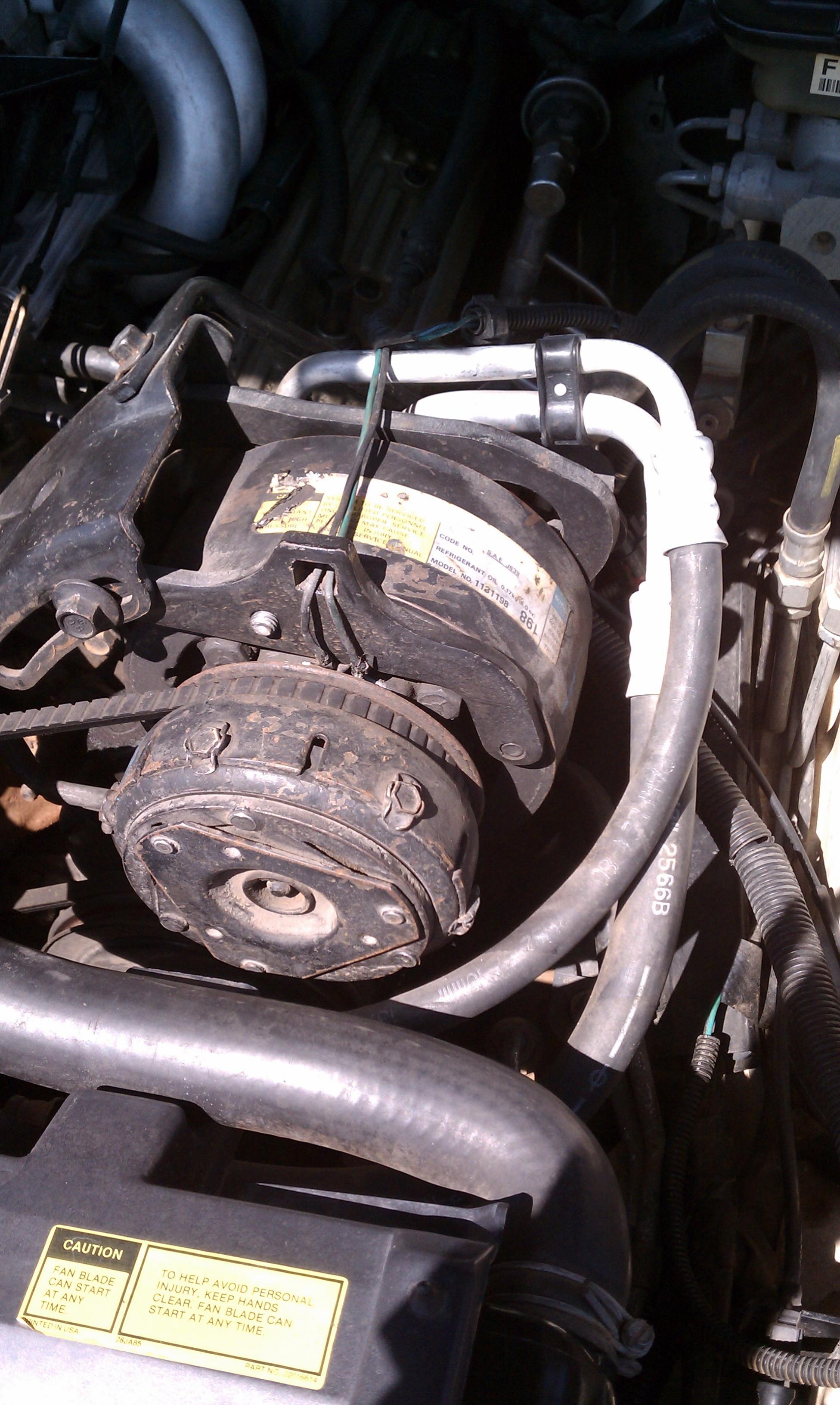

Was hoping you guys could tell me what kinda sensor I am holding in these pics. I took A pic of my AC because the PO said he had put R134 in instead of stock AC. Found this dangling in my engine compartment does anybody know what this is so I cant reattach it. Any help would be appreciated thanks.

It's beyond re-attaching.
It's about half of the low-pressure cutoff switch. The rest of it is probably still screwed onto the side of the accumulator.
Super easy to replace, and not too $$$, though.

Awesome thanks man. As far as my ac being r134 does that look like an r134 unit? Not the stock one right?
Thanks again.
Old Sep 10, 2012 | 06:58 PM
Posts: 28,026
Likes: 2,497
Re: AC Question.
Doesn't matter. All the same.
