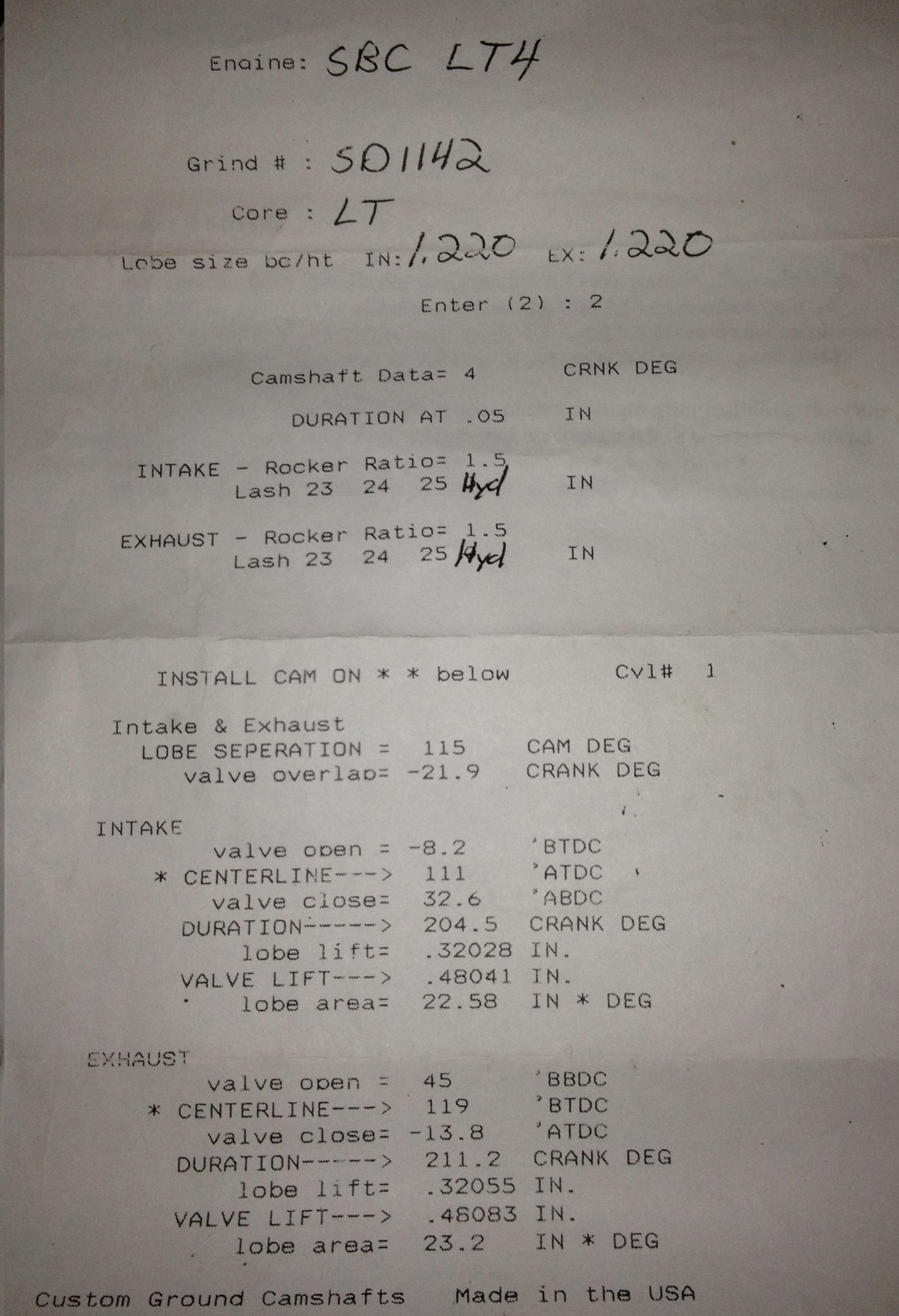

Hey i didnt know exactly what you were looking for so i took a pic of the Sheet for ya hopefully you can find it

Looks like it's 204/211 duration at .050... just by eyeballing it thats too small to make 10.2:1 work. Im not smart enough to figure out form that chart what your total duration is (not duration at .050) so I cant really check it.

If you're married to that cam... Its actually shorter in duration than an L98 cam, but much more lift. It's honestly a pretty good cam for someone that's trying to work around the TPI's limitations. It might even be good for working around the TBI's limitations, but it seems like everyone who gets to the limit of TBI just trashes it before even trying to make it work. Just watch your fuel pressures and make sure it doesnt go lean at high RPM's. Big injectors, etc. Gotta watch it!
That cam will be easy to tune, and make tons of vacuum, work with your stock stall converter and stock gears, all that. But what it wont do is make lots of power. It will make, at the lower limit, stock vortec L31 power, so at least 250hp, which is more than L98, provided you can fuel the thing properly. Add headers, exhaust, you may be pushing 260-270, and you'll get pretty good gas mileage while you're at it.
Like every other hot engine build decision, you have to choose between practicality and low end power( "torque" ), or trading that away for high RPM horsepower. It's not one or the other, it's a continuum. The farther towards the high RPM power you shift the engine, the more changes you will need to make throughout the car to make it work and the more stress it all goes through in operation.
If you stay with that cam, go with some dished pistons. I'd get the compression down to 9.5:1.
